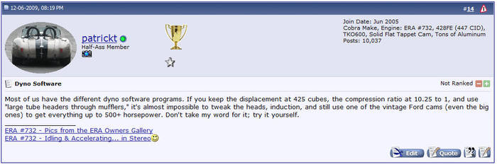

patrickt 12-21-2009 07:10 PM
Originally Posted by Barry_R (Post 1011566)
Based on this experience I'd say it would be very hard to hit 500 with a stock 427 factory combo...
Wait a minute, that's what I wrote way back on page one....:LOL:
http://www.clubcobra.com/photopost/d...edium/4273.jpg
