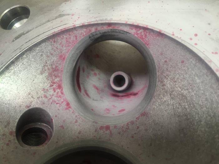

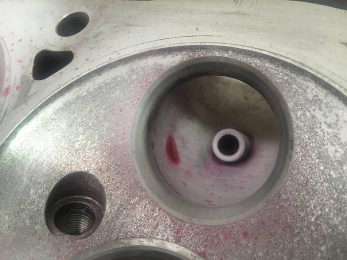

Big day of disappointment yesterday when the crack test of my heads revealed they are nothing but POS. These heads are Coon heads and machined by Keith Craft.
My machine shop has told me that in some places the exhaust to water jacket is no more then 1 mm (40 thou).
The photos below show all of the porosity and cracks that are in them, for those that dont understand the dark purple areas are where porosity is and the dark purple lines are cracks.

That would be the worst case of head porosity I've ever seen.

I used these people for porosity issues with my Dove tunnel wedge manifold. They do a lot of bulk work for quite a few major auto manufacturers.
Vacuum Impregnation
Detroit Bill 02-26-2015 06:13 AM
Porosity is an issue with Aluminum castings. OEM's treat parts.
