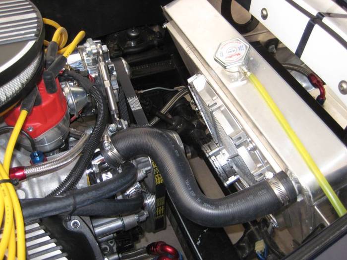

I received my surge tank last week, and it is now installed. My setup started with this:
and now looks like this:
and this:
Since I already had a radiator cap and overflow line on my radiator, my mechanic buddy suggested we just plug the two outlets on the surge tank with brass fittings, move the 16# cap from the radiator to the surge tank, and put a 13# cap on the radiator.
The outside temperature was just a little above freezing this weekend (burrrr!), so I haven't had the opportunity to drive it at length, but the engine compartment looks great with this new addition.
