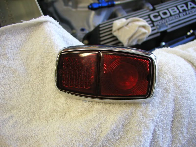

I built a set using the retangular lights as a base. The LED's came from Custom Dynamics. Here are a couple of pics.
http://i61.photobucket.com/albums/h7...a/P1010007.jpg
http://i61.photobucket.com/albums/h7...a/P1010010.jpg
http://i61.photobucket.com/albums/h7...a/P1010008.jpg
