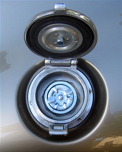

I've seen two videos of FFR cars on road courses flip. One was caught on a dash cam from the car behind. On a previous thread a year or so ago this whole topic was discussed in great detail and another issue that was brought up was the Lemans filler caps. Many of the replica brands do not use a regular gas cap inside of the Lemans flip top. Some have them as standard equipment. With a single roll bar as the car rolls the Lemans release lever can get pushed and the fuel goes everywhere. I'm a firm believer in guys doing what like with these cars but for me and my passenger I like double roll bars or a full width bar.
Were these FFR's spec racers? My only comment here is that FFR cars are generally home built and the SPF's, CSX's, Kirkhams, and to some extent ERA's, are generally factory built. Maybe all manufacturers' cars have flipped at one point or another, but the original 1960's era Cobras were raced for many years, including Dick Smith going 198 mph in one. But, no, they're not as safe as your Camry.
I think having an interior gas cap under the Lemans cap is smart. That's why I added one. ;)
Jamo had a neat trick to safety wire the cap for competition. Made it so you could just barely slide the wire off the hinge for gassing up on the street. I've used it and it works.

patrickt 03-19-2011 06:28 AM
Originally Posted by Bill Bess (Post 1117200)
Gee, I never thought of the added safety value of an interior gas cap under the Le Mans flip top cap....I now feel better.
Here's a shot of the ERA cap. I can almost imagine how scary it might be to be roughed up a bit, hanging upside down, trying to unsnap your belts, and watching gas trickle out and run by your hot pipes.%/
http://www.clubcobra.com/photopost/d.../gascap001.jpg
Wbulk 03-19-2011 06:37 AM
Based on Patrick's picture I made my own about a year ago. Old picture.
http://www.clubcobra.com/photopost/d...ion_Small_.jpg
The fill neck comes up through the truck. The aluminum trim ring goes over the top of the neck and the Lemans cap goes on top of that. Picture color is bad for some reason. Had a bad color day.:LOL:
http://www.clubcobra.com/photopost/d...ces_Small_.jpg
