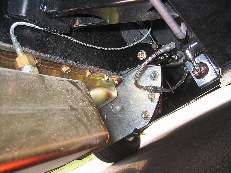

patrickt 11-29-2011 05:06 PM
Paul, FWIW, Canton Pan, 8.5 qts w/ cooler and remote filter, sensor on the top, NEVER a problem with the sensor being in the oil. Restrictors on the heads -- .060 in size.
http://www.clubcobra.com/photopost/data/500/bung001.jpg
