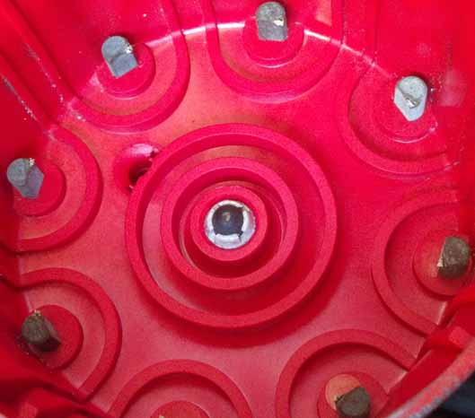

The car started missing at first I thought is was fuel related because of the dark soot and occationally 4' flame coming out of the exhaust but I check the FI mapping and it wasn't doing anything crazy. Then I started checking the ignition system. I swapped the coil (had a spare) then I looked at the cap (in this order mostly because the cap is a PITA to get off with the TWM rail system. I think this might be the problem, I'm planning on getting another cap. The rotor looks OK but I'll change that also.
I have under 2000 miles on this cap. Does this look normal?
To me it looks like a lot of buildup for 2K. Additioanlly, it looks like it is not firing while the rotor is in the middle of the post. Can this be changed?
Details: ignition MSD 6D, Distributor MSD, FAST Brain

Ozone & moisture buildup...even in a vented cap....solve this problem and you'll be rich.
Been all kinds of ideas to minimize this from drilling additional vent holes to a continuous vacuum purge connection added to the cap.
Just be sure your center connector on the rotor is touching the carbon button...The spark will jump to the contacts as soon as it has enough energy to do so, it won't wait to be centered on the post.

it does seem a bit off.....as far as mileage i normally get about 3000 mi from a cap.
actually it looks better than mine usually do.
like blas said the center electrode is usually the pain you get from these caps. just bend the rotor tang up to be assured of a good contact. i found caps to be a bit sloppy of a fit on the housing.
msd told me to drill a small hole in mine, oriented to the rear of the cap

The buildup on the posts doesn't look too bad, but you may want to do a search on "rotor phasing". It's possible that the small buildup in conjunction with bad phasing could cause your misfire.

Thanks for all the input. The buildup is all on the lower edge of the post which makes me thing the rotor is not lined up with post and below it. I'll look up phasing.

Agree with all the prior posts. MSD quality is definitely lacking. Check phasing as noted. Mine was OK, but I noticed like yours that the rotor was under the cap contacts! I cut off rotor tip and added another tip on top of original to raise the contact to proper height. You would think MSD could do better than that. Does anyone know if there is an alternative cap for the smaller diameter 351W distributor?

I get some of the build up on the posts. I use a Dremel tool with the soft wire wheel. The build up comes off in seconds and the post looks good!

Blas, for me this is my first cap and rotor and I haven't touched them b/c the are a pain to get to with the TWM fuel rail in the way. The rotor looks to be in great condition at the center point and on the edge. No wires moved and insid ethe housing looks clean with no carbon or other crap other than on the cap post.
I've never had a problem that I could tell and this came on pretty fast (within 20 miles after a cold morning start). It began to miss on multiple cylinders at highway speeds, it felt like a way rich condition (it was because the plugs weren't firing). When I punched it, it would come back to life, kinda, sometimes it bogged down other times it worked. This again made me think it was fuel. I'm tempted to clean the current one and give it another try as I wait for the new cap and rotor to come in just to make sure this is in fact the problem. I know it is not lack of fuel!

So I did a little touch up on the cap, I think I made the contacts clean enough to be somewhere between new and where it was in teh photo above. I put everything back together and it started up fine. Within a minute it gets crappy, you can hear the change in the exhaust and it idles poorly. Fuel pressure is at 45psi. FAST is remapped with a good file that I know works. I have replaced the coil and cleaned the cap. What is next the MSD distributor or the MSD box? or am I going the wrong direction and it is something else?
When I had it on the road last week as this problem started and I nursed it home, it would "clean out" when you stepped on it sometimes other times it would bog down, it was inconsistant.
I didn't screw with the distributor or the MSD box nor have they gotten wet or have there been any changes to the electrical system.
