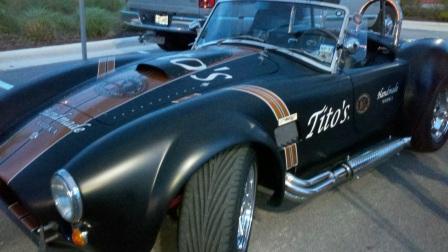

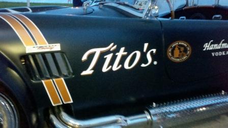

Wrapped Cobra in Tx
I was really impressed by the quality and cost when I saw this one at the annual Tx Cobra Club Spring Meet.
http://www.clubcobra.com/photopost/d...pped_Cobra.jpg
http://www.clubcobra.com/photopost/d...ed_Cobra_2.jpg
Paint job underneath is identical to my car, Indigo Blue, Pearl White stripes.

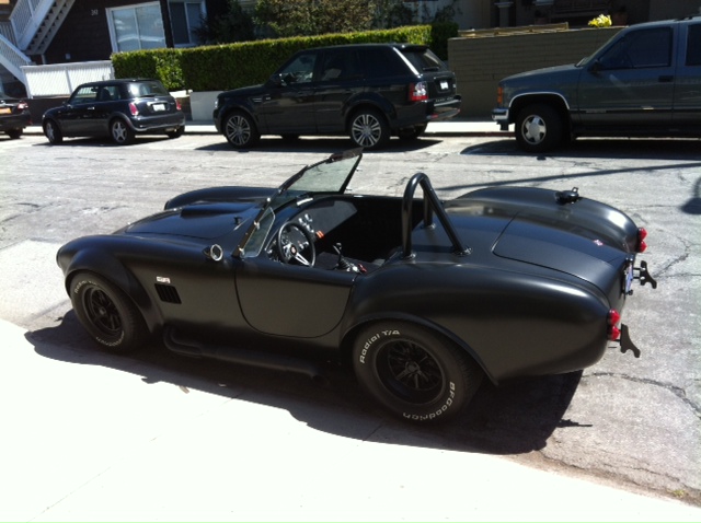

Fred Z 06-28-2012 09:59 AM
before
http://www.clubcobra.com/photopost/d...R_5215_051.jpg
after
http://www.clubcobra.com/photopost/data/500/New_1.jpg
Just to show the before and after view of the car. I still love the paint better and am going back that direction.
