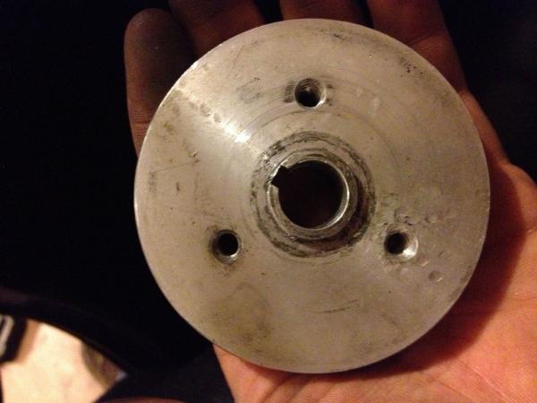

Hi everyone! My first post for my less then one week old owned Cobra! I'm trying to track down the make of this boss and to see where I can order a new one. The center spacer in this one is worn out and so there is a lot of play in the steering wheel. Thanks!

If there is enough material there take it to a machinist and have a bushing made for it .

I tracked it down and was able to find out some history on this. This is a custom-made boss assembly by Shell Valley Companies for all kits made prior to 2010. This boss assembly is DISCONTINUED and no longer available for purchase. They no longer make this part because of the issues: The key pin and/or bushing wears out and cause play in the steering wheel. You will have to change the steering wheel shaft and the steering wheel.
This is an 1 1/2 inch steering wheel shaft so make sure your new shaft is 1 1/2 inches too or you'll have to drill out a larger hole in the dash and do a bit of customization to make it fit. The good news is you can put a spline boss in and fix the play in the steering wheel. This part fits onto a threaded rod and has a key pin to hold it in place.
