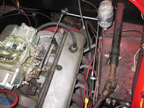

This is a picture of the linkage we made. We copied Unique's throttle linkage but custom fit it for travel. By using rod ends I don't think you will get a bind.
Cost about $50 in material and a couple of hours of time.

As, I see in
the pictures with the rod from the carb going to the firewall, this looks very dangerous to me if
the motor moves at all!!! This fulcrum should be attached to the motor for sure....

Originally Posted by CHANMADD View Post
As, I see in
There is much more of a chance of the cable sticking than the engine mount breaking allowing the engine to torque enough to cause WOT.
I have had a number of vehicles in the past with cables that stuck, only one with a broken engine mount that would cause this problem and even with a cable it caused the same situation. (68 Firebird 400 with cable).
Using this logic seems more of a way of justifying your setup than reality. After all, push the clutch in and let her blow!
I'm in much more danger from my showing out than equipment failure in one of these cars!
