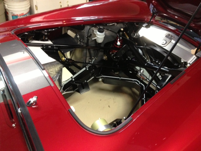

I built a tribute Cobra rather than a replica. it has a space frame and is running an LS6 engine. The frame design forms a VEE, the point of which is behind the radiator. I sealed the engine compartment. There is an aluminum cradle on top of the frame that seals the frame to the body. The frame is 16 inches tall and is aluminum skinned. I put 2 side vents per side. They are stacked. The radiator stands straight up and is only 18 inches wide and 12 inches tall. I have run it on the track at high speed with out any perceivable lift. And it runs cool. I've never had a temperature problem.
john chesnut 06-08-2013 10:49 PM
Here is a picture of the double side vents and engine compartment. I have since routed the air filter to the front of the cradle, installed a longer throttle cable, and raised the rear ride height slightly. Next are vintage looking wheels. Always something to do.

My car has a Cobra body but everything else was custom built by me. I was trying to duct the air passing through the radiator out the side. The engine compartment is sealed and the air is ducted to the side. I don't run inner fenders either.
The frame is a space frame skinned with aluminum. It has a flat bottom with full aluminum under tray. The Trans tunnel is a stressed "Backbone". I sit in the frame, not on top of it. The headers are routed up and over the foot boxes. They pass through the cut outs in the aluminum body cradle. (I think the radiator is 14 inches tall not 12. I can't remember exactly.)
I will have to try the yarn test. But, I do know that the car runs cool and is very stable at speed. I have never felt like the front end was light.
