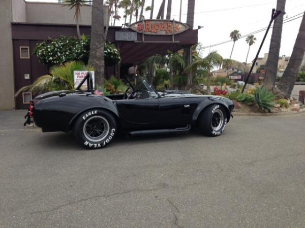

I have been a Roadster owner for the last 6+ years. I built a nice, very high end FFR. I went with all the best equipment possible with the exclusion of tires. I read and read and read every thread and asked many folks what worked best for the ride, but also the look. I went with BFGs as they last, look and drive as good as most. This is with exception to anything other than 15" dia tires. I had helped in the beginning getting Avons on board but never went with them as I just wanted more bulging sidewalls for the look.
Recently I redid my car, putting a brand new body on with the Paint job by the "Batman", Jeff Miller. Car is sweet but missing something. Which brings me to the BB's. I heard and read how they ride weird, hunt the streets and flat spot and more. It kept me away until now. I pulled the trigger and went with them....knowing what I should expect to deal with. Result:
they never wander,,,,never hunt....never lose drivability and so far...no flat spotting. I am blown away! Had I known this was the ride I would have had them 6 years ago. Now, maybe I have a unique set...but I doubt it. Even my tire specialist warned me. He balanced them and put them on and I have to tell you....they are awesome! I don't have power steering nor brakes...didn't want them. But what might I be missing here? I drove curves...I took them on the lined freeways at over 100mph....drove them on bad roads just to over do the test....I tried to actually get them to 'hunt' ...they rode no different than the BFGs. Anyway, I am taking the time to let others who may be thinking of BBs and helping them with a different take on them. I will post a pic below for your satisfaction and proof.
thanks for all who helped.
fred
http://www.clubcobra.com/forums/pict...ictureid=10230
http://www.clubcobra.com/forums/pict...ictureid=10222
http://www.clubcobra.com/forums/pict...ictureid=10231

Fred Z 06-20-2013 10:39 AM
Thanks for cool words
Nope, not handy on specs for alignment but was planning on slight toe in but didn't as they ride fine. No vibrations, not hunting and corner nice. Can't explain it but these are from Roger K! These are not blue streaks and they ARE Eagles, if it helps u to know more. I will reiterate.......heard all the scaries and even guy at RK said to be careful , they do this and do that! I was prepared for the dirge of the ride. NOPE, NADA, THEY R SWEET.
Now, as I said on FFR site....not advertising you get what I got, but I just ordered simple and put em on! Some of u asked about the car specs:
550 hp and same torque, IRS and coil overs, etc. Nov, '06 built and just coming up on 35k. So, in case someone wondered if I am out of touch w the car, u know I am not.
I will put up a few more pics for your review
Hope this just helps some who have been considering.....
295 rear, 245 front
