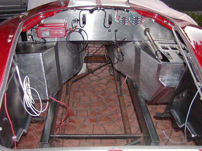

Not sure you could do this on a completed car, but I added some aluminum heat shields to the outside of the footboxes before the engine was installed. They have about a 3/16" air gap and it really helps keep the heat off the footboxes.
http://www.clubcobra.com/photopost/d...ields_002a.jpg

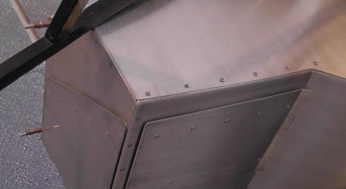

Rick Parker 07-21-2013 11:54 AM
This works great:
http://http://www.clubcobra.com/photopost/d...icture_348.jpg
