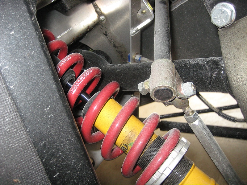

One thing that suprised me a bit is that the ERA manual indicates rear ride height can be adjusted by changing just one of the double coil-overs on each side. I would have thought it best to keep them exactly the same but apparently that's not a big deal.
Kevin
patrickt 01-02-2014 10:20 AM
Not on the ERA rear -- it's only got one shock per side, and the spring on that baby is 550lbs.
http://www.clubcobra.com/photopost/d...gspring001.jpg
kevins2 01-02-2014 10:25 AM
Obviously I'm talking about the Jag rear...
patrickt 01-02-2014 10:27 AM
Yes, that was the other great regret for Chas... that he never upgraded to the ERA rear.:cool:
