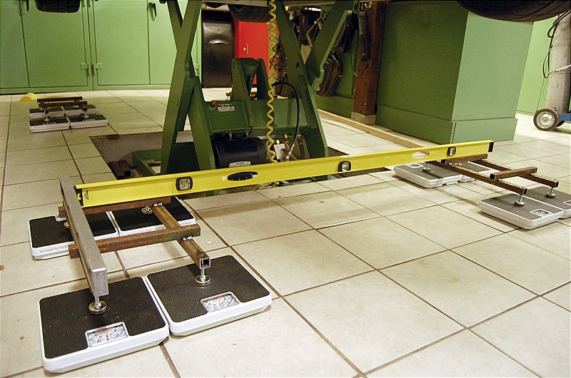

patrickt 12-22-2013 12:00 PM
Originally Posted by kevins2 (Post 1276907)
As for corner weighting, I'll have to ask around locally to find someone to help with that.
It's not hard. The hardest part is just finding the scales, but usually someone in your local club has them. You can even do it by cleverly cantilevering on to bathroom scales to reduce the apparent weight. But you've got to do it. The world will come to an end and you will never be happy if you don't.:cool:
kevins2 12-22-2013 12:04 PM
Originally Posted by patrickt (Post 1276908)
...The world will come to an end ....:cool:
Well, I certainly wouldn't want to add yet another reason for the world coming to an end. Enough of those out there already **)
patrickt 12-22-2013 12:15 PM
Now, if you just happen to have 16 bathroom scales sitting around.... Or, more likely, you just order 16 of them off of Amazon, set your corner weights, then return 15 of them for a refund saying you accidentally hit the wrong key on your smart phone when you placed the order.:LOL:
http://www.clubcobra.com/photopost/d...hscales001.jpg
