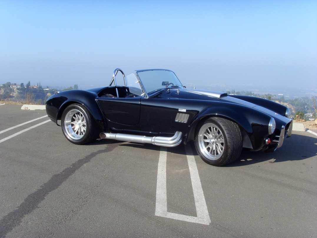

Here's a Hurricane I built a few years ago. Awesome kit.
