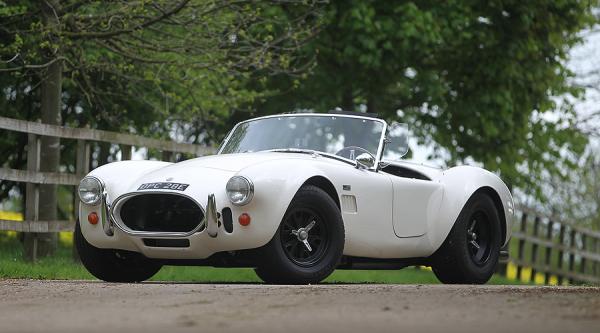

xb-60 05-29-2014 03:42 PM
More undercar...
http://www.clubcobra.com/forums/pict...ictureid=12237

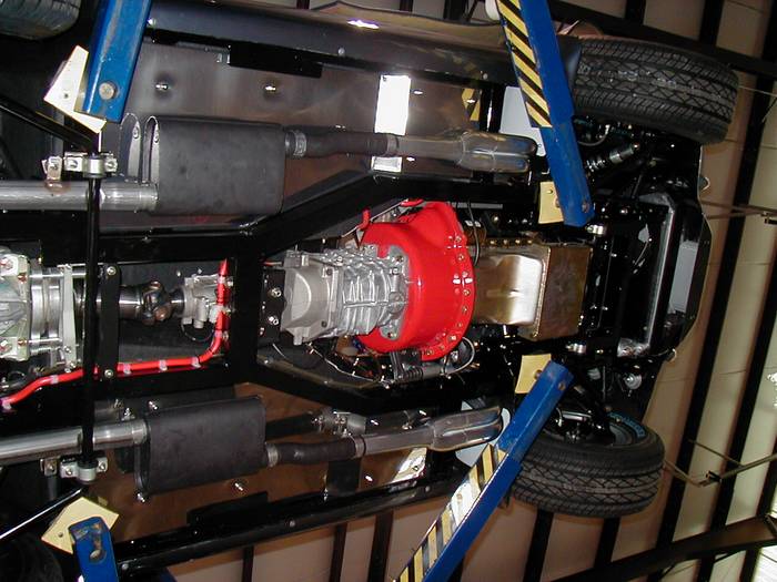

K98dave, here is my uncercar installation from beneath:
[IMG]http://www.clubcobra.com/photopost/d...46P6120024.JPG[/IMG]
[IMG]http://www.clubcobra.com/photopost/d...46P6120022.JPG[/IMG]
Mark IV 05-30-2014 11:45 AM
Note that SPF does the undercar with stainless pipes and puts "stand-off" heat shields between the mufflers and the floors with a .5" air gap to reduce heat transfer.
