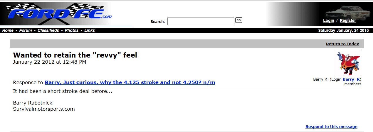

patrickt 01-24-2015 01:12 PM
Originally Posted by AL427SBF (Post 1336692)
Talk to patrickt if you are still confused about this, he spent a lot of time looking into this with his 428FE ;)
I went with a "shorter" 4.125" stroke, along with other light weight stuff, for a "revvier" engine, because that's fun to do (not for any hardcore racing). My builder said doing that was smart, Brent says doing that is dumb, Barry R. says doing that can be smart, Keith C. says doing that is just dumb. That's the summary. Pick the engine builder you want to side with.:LOL:
blykins 01-24-2015 01:22 PM
The stroke doesn't define on how quickly something can rev. Period. I'm so sick and tired of this being spread around.
If this were the case, then as I mentioned before, the 428 Super Stock guys with offset ground 428 cranks couldn't turn 8000 rpm and make 800 hp....or.....the Mountain Motor Pro Stock class guys couldn't use a 5.500" stroke crank, turn 9000 rpm, and make 1500 hp.
Look up Jay Brown's big inch SOHC and tell me how high it revs...4.250, 4.375, 4.500 strokes, turning 8000-9000 rpms.
patrickt 01-24-2015 01:26 PM
See what I mean?:LOL:

patrickt 01-24-2015 03:48 PM
Originally Posted by blykins (Post 1336713)
FWIW, Patrick (and whoever else wants to see another opinion), I texted Barry with this message: "I'm so tired of hearing people say that big stroke engines rev slow."
His reply was: "Send them over to Kaase's or Sonny's."
I can screenshot the text if necessary.
In response to "Why did you go with the 4.125" instead of the longer stroke?" He wrote the following: "He wanted to retain the revvy feel." I win.:cool:
http://www.clubcobra.com/photopost/data/500/revvy.jpg
