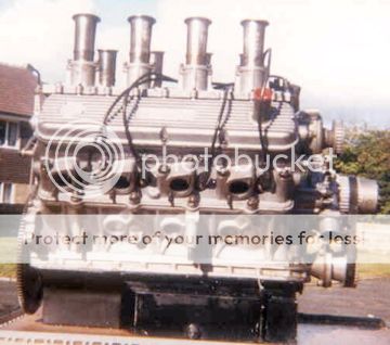

Guido36 05-17-2016 10:59 PM
Mark - you are absolutely right. Those are the same heads on an iron block in your link.
As far as I know the de Tomaso P70 had an all aluminum engine and this may have been the engine in the de Tomaso Museum, but the Sport 5000 showed up in California a couple of years ago with these heads on an iron block engine. I am still getting upload failures on the photos even though they are all within the acceptable .jpg size limits. But if you click on the links below you should be able to view them in my Photobucket album. These photos show my all aluminum engine ca 1978/79. It certainly looks all the business! I spoke with Pete Brock about this a few years ago and he remembered the all aluminum engines from his work on the P70.
What I am trying to discover is whether this was the same or similar block as 1963 Ford Indy pushrod engine with the four transverse mounted Weber 48 IDAs as driven by Dan Gurney. I am also interested in finding information on the XHP 260 aluminum blocks and the 289 aluminum blocks.

Jac Mac 05-18-2016 12:45 AM
The heads in pics posted by Mark do not have provision for the two extra cyl head bolts per cyl that the Indy 260 alloy block was cast with, so these should/must be another alloy block casting based on the factory 260 block if these engines were as you describe.
Note also the cresent shaped coolant transfer passage which also suggests the block would be based on early production 260 ford block as IIRC the Indy car blocks were dry decked with circular (O-Ring) for coolant transfer.
Guido36 05-18-2016 09:34 PM
The external oil pump is one thing that sticks out on this block - literally! Did any of the 260 and 289 aluminum blocks have an external oil pump? Maybe this is something for the GT40 experts?
What is clearly stated in several articles on the P70 is that Shelby supplied de Tomaso with the engines before he withdrew from the development, but not until after he had dispatched Pete Brock to Italy to work with Medardo Fantuzzi to rework the unsatisfactory first Italian attempt at translating the Brock design from paper into full scale aluminum.
Does anyone have any history on the 260 and early 289 aluminum blocks?
Jac Mac 05-18-2016 10:57 PM
These pics from links on your thread create more questions. In your side view of the alloy block and heads it has the extra head bolts and notice that beside each exh port it has a longer stud ala 351c wheras the pic from link by Mark S has no extra studs and short ( normal ) type SBF outer row of studs.
Re-read chapter in Des Hammill book, it appears that there might have been two or more evolutions of the early pushrod Alloy Indy block, but in saying that the castings of block in your pics have a more 'european' appearance. If you disassembled that block did it have provision for wills & O-rings at deck surface, or just flat for conventional gaskets.
