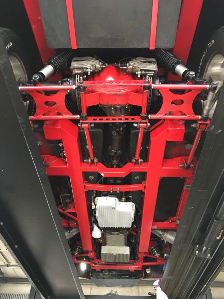

Gentlemen,
After searching the site to the fullest extent I'm going to put my hand up and ask for some assistance in identifying this Cobra.
My buddy purchased recently and was told it was a "early B&B car". I've been around these cars for awhile and the rear suspension is completely uniqiue - haven't see one like it previous.
Don't see any of the hallmarks for the big brands and am wondering if it's a one off. Nice car overall but buddy (and myself who does a majority of the wrenching) wants to know for parts replacement down the road.
See below pics and thanks to all in advance for any info/light you can shed.
NOTE : Looks like I can't post links/pics quite yet. If someone can shoot me their email, I can send a link to all photos to repost.

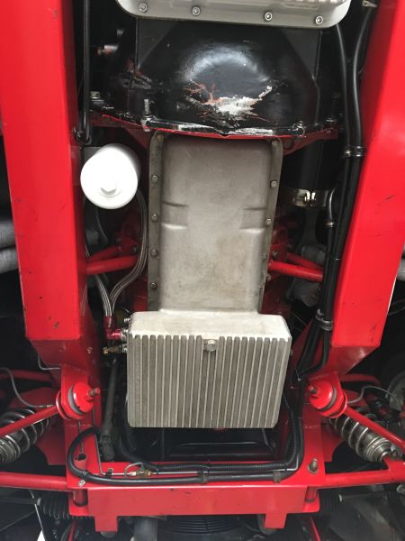

LMH 09-01-2016 11:00 PM
Could you take a couple photo's of the front suspension from under the hood?
Rear suspension and frame is very clean but I don't recognize it right off. Maybe some else will though.

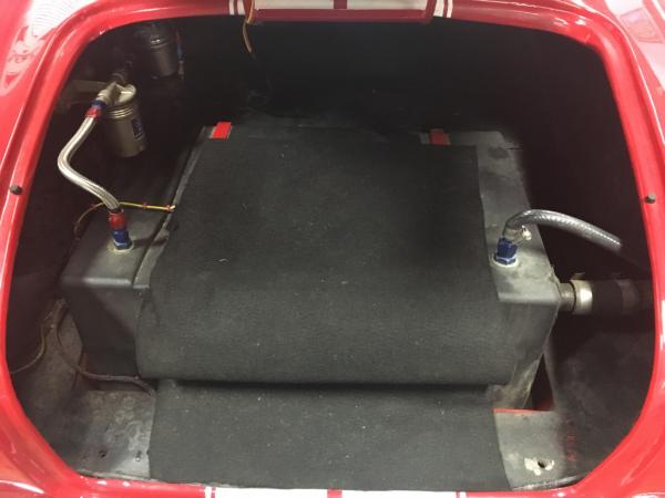

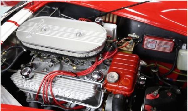

mrmustang 09-02-2016 03:55 AM
The general layout looks to be an early B&B, yet the early B&B was not available from the factory with an IRS set up as you show.
Pictures of the engine compartment?
Firewall?
Trunk area
Outer body?
joyridin' 09-02-2016 06:52 AM
Nice rear axle set-up! Ford 9" pumpkin with a Jag set-up. Somebody invested some money in that!
Saleen09 09-02-2016 01:11 PM
Firewall?
Trunk area
Outer body?
Uploaded all new pics as requested.

DanEC 09-03-2016 04:16 AM
The body has the dip in the fender line where the rear of the front fender and front of the door meet which is characteristic of the B&B. However, I think before there was B&B the molds were used by another fabricator whose name I believe was LA Exotics. It is lacking the deep skirt around the hood opening which B&B and LA Exotics had - but possibly it was trimmed off before painting.
I suspect it's one or the other but the frame sure doesn't look like a B&B which has a steel floor under seats welded to the frame rails. Plus a B&B frame is 2x4 tubing and that looks like 4x4 tubing. Not sure if LA Exotics used the same frame or something different. Possibly it's a custom built frame.
Saleen09 09-03-2016 12:01 PM
It is mainly 4x4 framing in the main area. The frame itself looks beefy to say the least.
You can't tell from the pics but the entire rear suspension including the pumpkin swing with the suspension, it's not hard/static mounted like the jags and most other IRS setups I've seen in my tenure.
That sounds a little similar to the ERA rear suspension where the IRS is mounted in a cage and bolts in at the top of it. The cage pivots and rocks slightly due to the swing action of the radius rods from the lower suspension arm and frame mount as the suspension compresses and rebounds.
