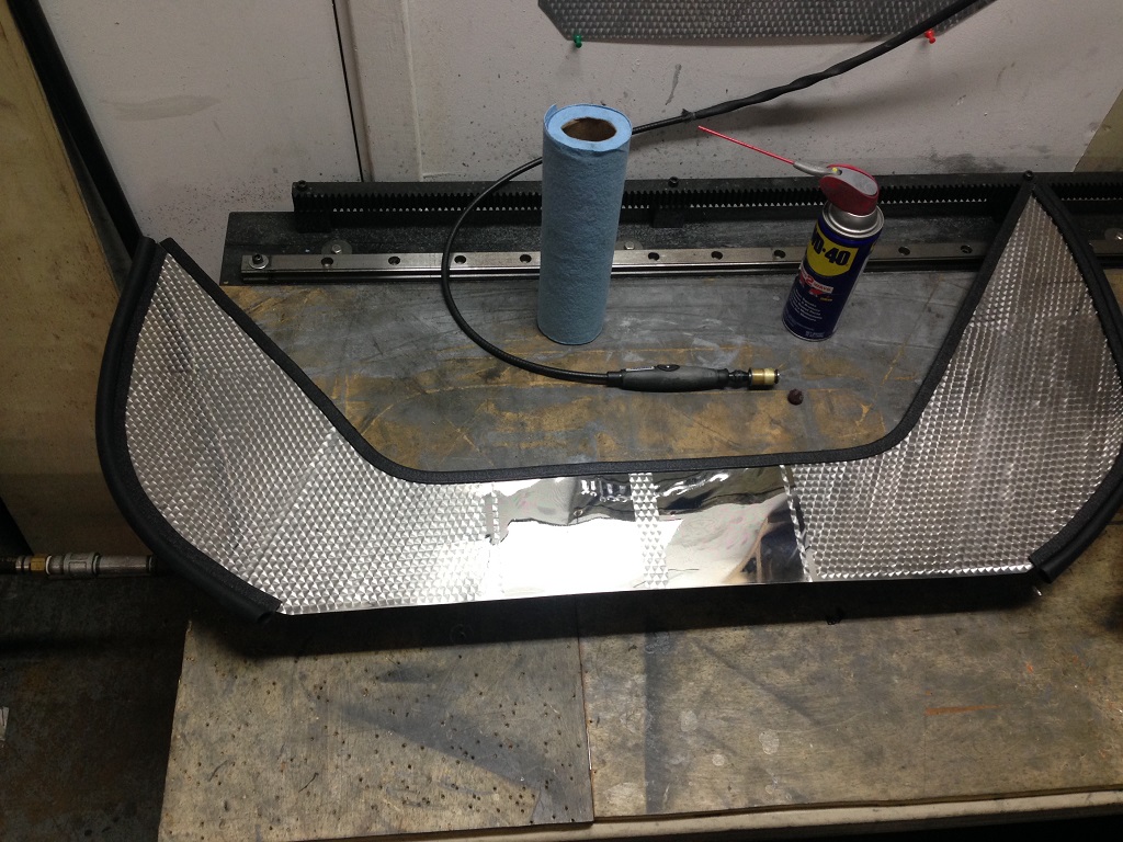

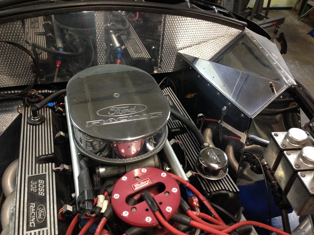

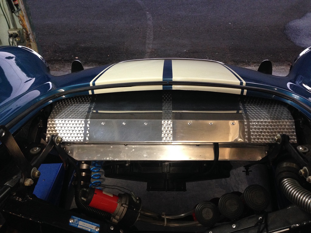

Replacing the heads on FF and decide to polish up the engine compartment. Went the rubbing compound route with heavy, not so heavy, medium, light medium, etc. with 5" pads from Fleabay. Finished up with 'White Lightening' a truck driver recommended. Mirror finish now.

I use Met-all. First discovered when working on commercial aircraft. The engine inlet lip skin was polished to almost a chrome finish. Very deep shine
MET-ALL POLISH from Aircraft Spruce

That engine cowling looks great.
But , I do have a life and will not be trying to get to that level.
