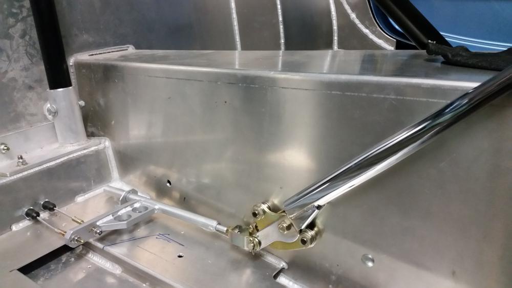

xb-60 05-27-2019 08:17 PM
Jim, what Larry suggested.
Here's what I did....
http://www.clubcobra.com/forums/pict...ictureid=17309
Glen
Jim Coleman 05-27-2019 08:20 PM
Wow!
Beautiful weld work on the aluminum.
Thanks for the tip.
Jim

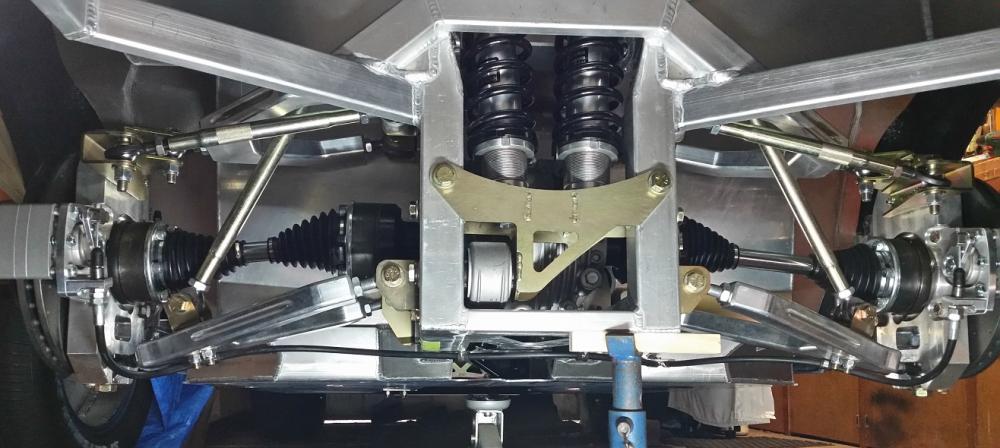

xb-60 05-27-2019 08:25 PM
Originally Posted by Jim Coleman (Post 1462352)
Wow!
Thanks for the tip.
Jim
Well, that's what this forum's for :)
Here's what the cables look like at the other end....
http://www.clubcobra.com/forums/pict...ictureid=17869
You can see where the two cables come through the bulkhead just to the right of the diff.
Cheers!
Glen
