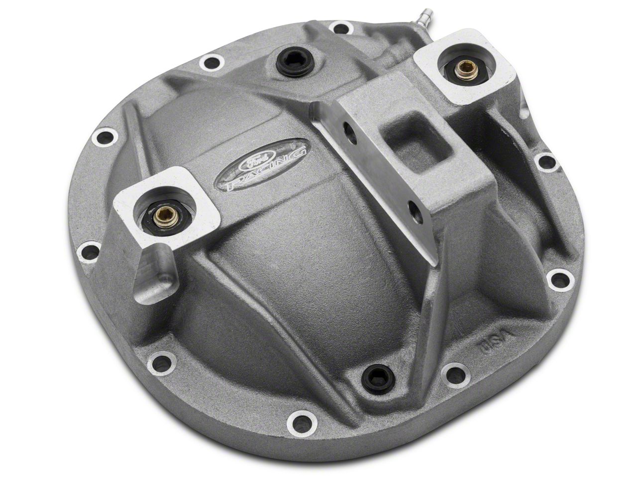

Ford offers a reasonably priced HD cast cover for the housing that looks like this;
https://turn5.scene7.com/is/image/Tu...prodpg640x480$
