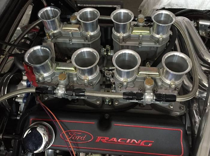

I mounted mine between the two front stacks using a homemade stainless bracket that mount with two of the screws that hold the stack in place. With the tip just above the stack. I understand this sensor read air temp in the engine bay. I wish I could post a picture but it to large.

I did it!

Thanks Dwight. Great pic and I like your solution.

Dwight's eloquent and simple solution got me thinking about how effective it is.
An 8 stack in the confines of our typically hot Cobra engine compartments , a low hood profile with little clearance and even if you have a hood scoop (whether you believe it scoops air or not), it probably doesn't matter that the AIT sensor is mounted in the velocity stack.
Mounting the sensor close to the velocity stacks in the "airstream" would probably measure the air temp just as effectively as if it was inside the velocity stack.
So I'm going to use Dwight's method of installing/attaching the AIT sensor.
