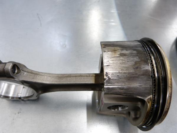

Everything inside the engine looked beautiful except the rear piston on the passenger side which had tried to weld itself to the cylinder wall. Obviously, a lubrication breakdown of some sort had raised its ugly head.
http://www.clubcobra.com/forums/pict...ictureid=21273
I had been hoping it was a spun rod bearing or something that could be fixed with some parts replacement. This was worse in that it had not only damaged the piston but also the engine block. Not something impossible to overcome but certainly more involved to fix. After some cussing and swearing, I decided the Cobra didn’t have enough power with the old engine and what was really needed is a 347cid engine to go with a new Tremec TKX transmission. After all, what Cobra can’t use a little more punch :LOL:

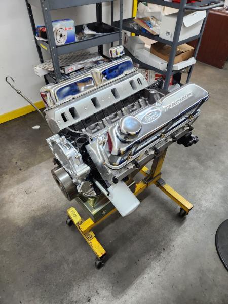

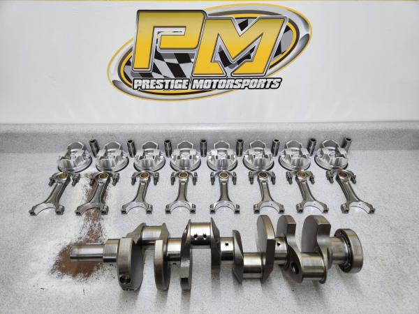

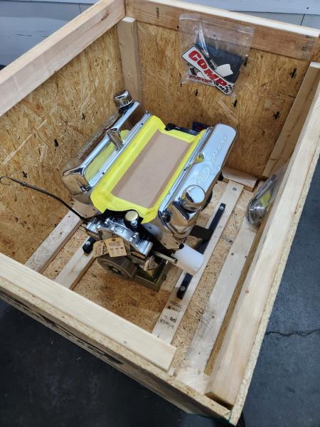

After shopping around, I decided the replacement engine would be a Prestige Motorsports 425HP 347cid longblock. I also frequent the GT40s.com forum and a lot of guys speak highly of motors from Prestige Motorsports. They build them to order and dyno test each engine to ensure it meets the advertised performance specs. This way I could reuse the Canton oil pan and EFI setup from the old engine. They also offered a 440HP version of this engine which is basically a more aggressive camshaft. I opted for the 425 version as that extra horsepower is way up in the RPM range where it virtually would never get used on the street.
The build took a few weeks and they provided pictures while all the parts were coming together.
http://www.clubcobra.com/forums/pict...ictureid=21275
http://www.clubcobra.com/forums/pict...ictureid=21276
http://www.clubcobra.com/forums/pict...ictureid=21277
Yes, every setback and failed engine is a great excuse for an upgrade.

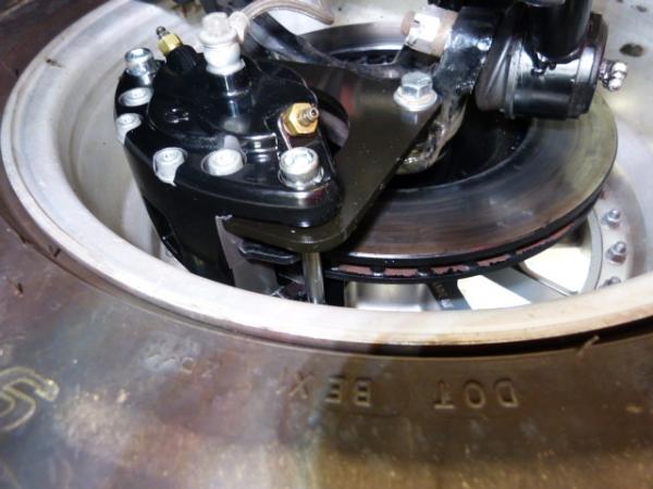

While waiting for the engine to be built and given the anticipated additional 125 HP, I decided to check out the brakes and rear end. After pulling the front calipers, I found the pads to be wearing crooked and thin. This Cobra has Mustang II front suspension and when first built was outfitted with the larger Granada rotors and GM “mid-size” single piston calipers (I believe D52 is the official GM designation). After further inspection, the cause of the angled/crooked pad wear is that the caliper brackets weren’t holding the calipers square to the rotor. Whoever made these aftermarket brackets did a poor job of designing/fabricating them and so off to the scrap bin for them.
Ok, so at a minimum a new set of caliper brackets and pads were required. The brakes had functioned adequately for the 50K miles on the car but as is the emerging theme here, every part failure is an opportunity to upgrade! So I decided to go with the Wilwood D52 bolt-on replacement calipers.
http://www.clubcobra.com/forums/pict...ictureid=21280
These units provide an upgrade to a double piston caliper and are made from aluminum for less unsprung weight. The piston surface area is about the same as what they are replacing so they won’t clamp any harder but should apply the pressure more evenly over the pads surface. With a new set of properly aligned caliper brackets, these should work very nicely. And yes, they do look better what little you can see of them through the Halibrand style rims.

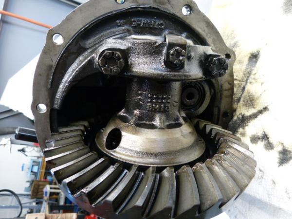

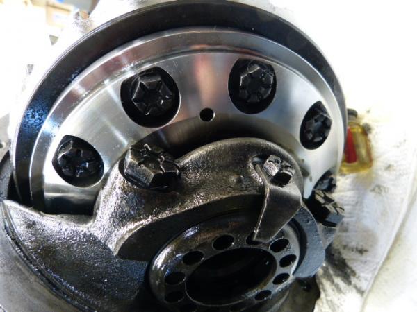

On to the rear axle which is a 9 inch outfitted with Lincoln Versailles disks. The pads here showed very little wear which tells me I should look at adjusting the brake bias so rear brakes are used more. Now to test the posi differential to see if it is functioning properly. I blocked one tire from turning and spun the driveshaft yoke. The other tire turned just like an open differential works. No resistance was felt at all like you should feel with a minimally working posi unit.
Ok, so the rear axle needs to come apart. It had a slow drip leak from the pumpkin gasket that had been bothering me for many years. Now I had adequate reason to tear it down and fix that as well. After pulling the 9 inch pumpkin, I discovered it had a Ford Traction-lok clutch style posi.
http://www.clubcobra.com/forums/pict...ictureid=21278
http://www.clubcobra.com/forums/pict...ictureid=21279
I looked into rebuild kits for this unit, which are available, but the Traction-lok is 50 year old technology and the popular opinion is that the clutch disks wear fairly fast (even with friction modifiers) leaving little to no posi function sooner than preferable. So you guessed it, every part failure is an opportunity to upgrade!
I decided to replace the differential with an Eaton Detroit Trutrac unit (which contrary to its name, is made in Taiwan) that uses helical gears instead of clutches to provide its limited-slip function. Popular opinion on these is that they work great and don’t wear out like the clutch-based units. The ring and pinion looked fine so after replacing the differential roller cups/bearings, I proceeded to reassemble and setup the rear end. I used a LubeLocker brand gasket and so far no leaks or seepage has occurred so hopefully one less oil puddle to wipe up on the garage floor.

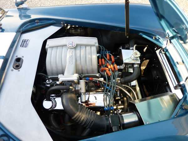

Now on to my current Cobra revival dilemma, the EFI/ECU system, should I stay with existing or upgrade to newer technology? I was anticipating getting the new long block motor, dropping it in the Cobra, topping it off with the old EFI unit and having it on the road already. I’ve had the new engine in my possession for about a week now, I’ve been busy “preparing” it for install and no rumble from the side pipes yet.
http://www.clubcobra.com/forums/pict...ictureid=21281

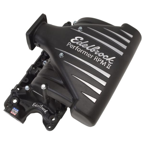

When you have a collection of aftermarket parts that make up your engine (the engine block is the only component sourced from a Ford factory), it’s most often more complicated in real life than in theory. Ford changed several things on these small block Windsor motors over the years that is most often the root cause behind complications. Things like drive belt pulley spacing, water pump hose inlet location, timing indicator/pointer location and an EFI intake that extends over the valve covers. So as I was working through preparations/adjustments, I decided to trial fit the intake manifold. I had made the assumption that if the intake fit over the existing valve covers and these same valve covers were used on the new engine, then the intake should also fit with no clearance issues on the new engine. Here’s a picture of the old EFI intake that has been on the car since original build.
http://www.clubcobra.com/forums/pict...ictureid=21282
So I went to great lengths to make sure the old valve covers would fit over the new engine valve train and thus I should avoid any complications there. That assumption proved false and my biggest complication so far. It turns out the new aluminum head castings are taller than the Ford X302 aluminum head castings that were in the old engine raising the valve covers upward by about ¼ inch. It’s no wonder why these heads flow better, they have more room for the passages and ports.
This wouldn’t normally be an issue but it is if you have a big, wide intake with minimal/no clearance between the intake plenum and valve cover top. I had to squeeze out all extra space way back when to fit the engine under the hood (even lowered the engine mounts by 1” as well). So even after grinding away about 1/8” of material on bottom of intake plenum, there’s still a gap in the upper and lower intake flange of about 1/16”. Any more grinding and there will be a hole into the intake, not good.
In trying to identify all possible resolutions, it occurred to me that an upgrade to a Weber style 8 stack EFI would work. In pricing it out, yikes, that’s an expensive option but boy, wouldn’t it like right at home in a Cobra.
http://www.clubcobra.com/forums/pict...ictureid=21283
I could also go down the path of buying a different long runner intake that has a shorter plenum, would fit over the top of the higher valve cover and still fit under the hood. A much cheaper alternative but just doesn’t have the same eye candy appeal of Weber throttle bodies.
http://www.clubcobra.com/forums/pict...ictureid=21284
If the 25 year old EEC IV system is left in place, it’s really a ticking time bomb and potentially the cause of the prior piston failure. Upgrading the ECU is a possibility but is doing that just a slippery slope to a new throttle body, distributor/ignition system, etc. etc. All this to just end up with an EFI intake that doesn’t really look right in a Cobra anyway. Those Weber ITBs sure have the right look but at 4X the cost, yikes!
Are there other viable alternatives I’m missing? I don’t really want to go a non-EFI option like carburetors. I’m told that the Borla ITBs are really the only non-junk ITB option out there.
I’d be interested in hearing your thoughts, options, etc.

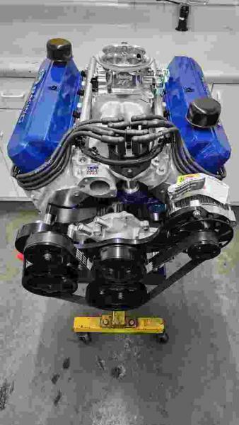

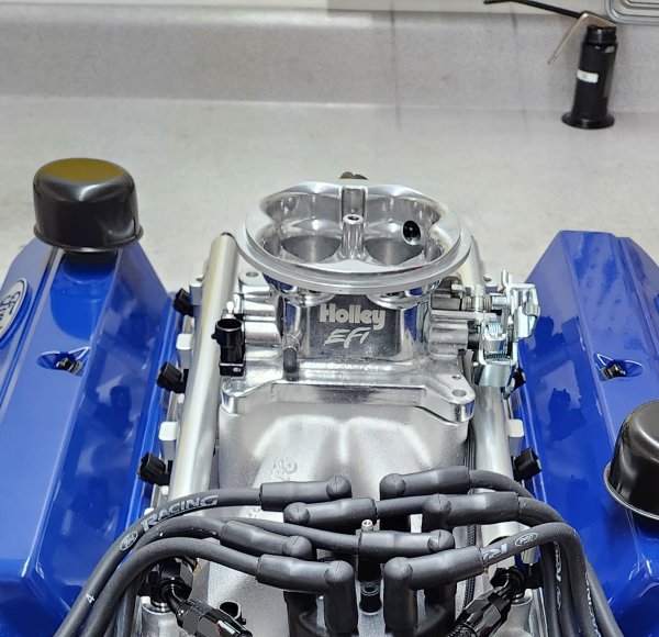

Here's the setup the guys from Prestige Motorsports are recommending. It's the Holley TerminatorX multi port EFI:
http://www.clubcobra.com/forums/pict...ictureid=21288
http://www.clubcobra.com/forums/pict...ictureid=21287
and maybe top it off with an oval Cobra air cleaner. If I added a turkey pan it would even cover up the EFI fuel rails.
I was at a dyno tuner today for a different car and the tuner highly recommended the Holley TerminatorX ECU and tuning software. Said in his experience it's one of the best available today.
In thinking about this further, if I go the multi port EFI route (versus Sniper or Stealth style) and I got the itch for a Weber style 8 stack later, then all that would need to be swapped out is the intake manifold and add Weber throttle bodies along with a new wiring pigtail for the imbedded injectors. The ECU, sensors, dist/ignition are all common/shared between the multi port and 8 stack systems.
Does anyone have experience with the Holley TerminatorX multi port EFI? Whether on a Cobra or other vehicle, I'd like to hear your experience, good or bad.
