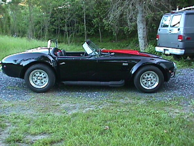

Danr55 06-20-2007 07:50 PM
1 Attachment(s)
An older Contemporary. Much like Jeff's car.
