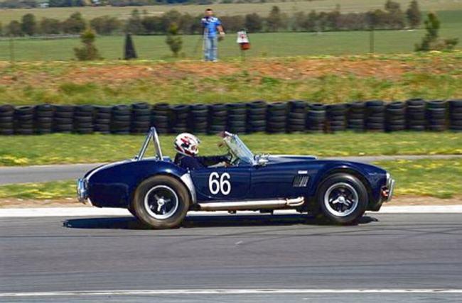

Old 10-29-2007, 08:43 AM
Bryan Wilson's Avatar
Join Date: Aug 2000
Location: Australia Geelong, VIC
Cobra Make, Engine: Real: Southern Roadcraft, SRV8, 351W stroker
Posts: 852
Default low bell housing
maybe I Should have a skid plate
COB-66 Young at heart old fart.
Don't drive faster than your guardian angel can fly.
If it doesn't matter what gear your in you have enough torque.
VK3KDN

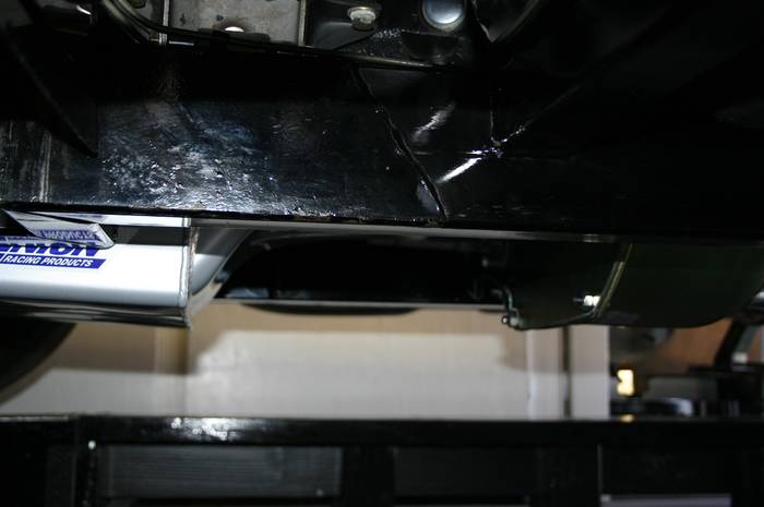

Old 10-29-2007, 09:29 AM
Banned
Join Date: Oct 2003
Location: Yorba Linda, CA
Posts: 3,293
Default Yes, it does.
Trimmed to maximize clearance (note the pan will hit before the McLeod bellhousing will)
