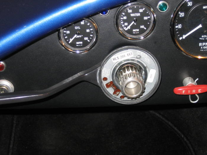

I mounted mine under the dash. Pull handle is on dash.
