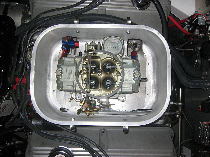

There's not a whole lot of clearance inside the pan. Here's a shot looking down, sans air cleaner, to help you decide.

This pan is a great idea. I like Rick's initial thought though, about the locating pins. Instead of having a few pins there strictly for alignment purposes, what if they were threaded? That way you could bolt the pan down from the inside and eliminate the springs.
It may take a little more time to remove, but still not as long as it takes to remove a regular turkey pan.

At the risk of being accussed of hi-jackig this thread, I have a question or two. These are the first detailed pictures I have seen of the turkey pan.
How does the pan seal up to the hood scoop, if at all? A picture of this would be most appreciated. I am assuming if it does seal up to the hood that it must be a thick flexable material to allow motor movement.
I am a little surprised that the pan is open for throttle linkage and such. I assumed it was sealed to provide some ram air pressure affect, but apparently it was only to supply cool air to the carb.
