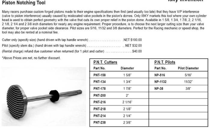

jdean 01-28-2008 12:09 PM
Without removing them, you can notch pistons......
http://www.clubcobra.com/photopost/d...notch_tool.jpg
