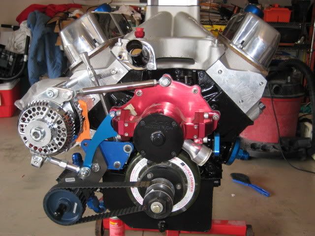

I have been running one since day one... Looks different (like) runs cooler than any of my previouse 4 BDR's (love). No issues and the ability to cool while sitting between sessions or after shutdown is very nice.
If needed, you can replace the pump within moments without breaking into the cooling system. Fortunately, haven't had to do that....
Picture attached:
