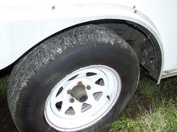

fsstnotch Josh There's the things to check, Make sure the tires are up to spec. The load range is most important on this. Make sure you go under the trailer and look for any frame damage. Check e-bay for prices for the same size trailer. Make sure the frame is not rotting out and the floor is solid. The size for a cobra is OK, You may have trouble fitting a full size car into the trailer with stuff in front. As far as pulling a full load, UNLESS on flat ground, DON'T use overdrive going up hill, slow down a little and let the trans go into 3rd gear without lockup. This is alot easier on the trans. Get a trans fluid temp gauge installed if you can. 65mph will get you there 5 minutes later than doing 70 mph and maybe in one piece.%/ You might want to look at the 24' trailers. They have more room for parts. You are going to be a brick pushing through the air. The wieght of car,trailer, and spare parts will out wieght your tow rig. I am looking at a lowhauler, for my needs. Enough for car and parts. More aero that standard size trailers. If have to work on car in trailer you are bent over anyway. Places I goto have garages anyway. You can also fit a lowhauler in the garage with a 7' door. Does your truck have a haul or tow mode? you want to use this with the trailer, it changes the shifting of the trans and gives full pressure to the trans all the time. Hope you are packed, stay safe, hear from you soon. Rick L. ps hope the breakables are out of the bedroom%/;):rolleyes::LOL::LOL:

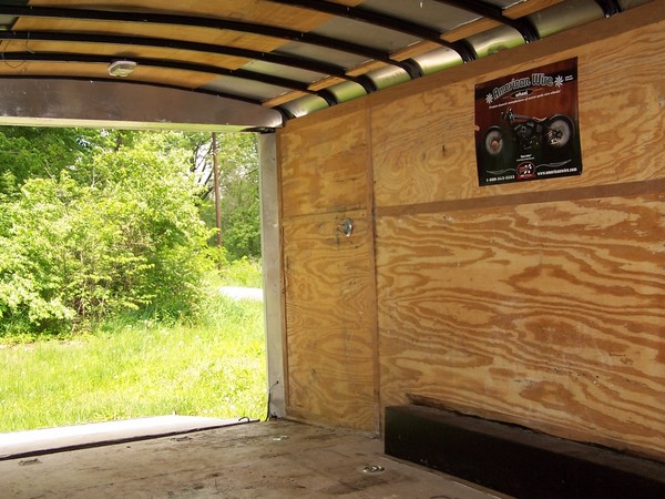

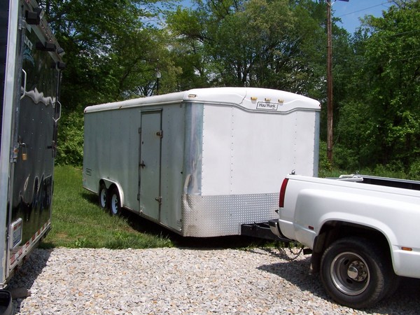

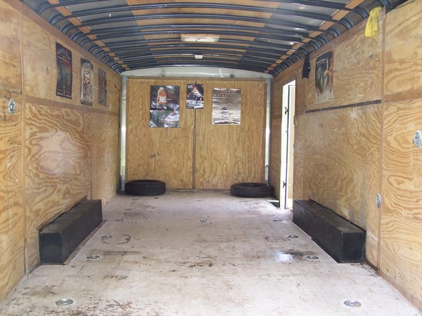

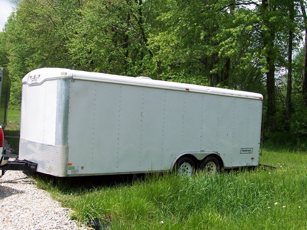

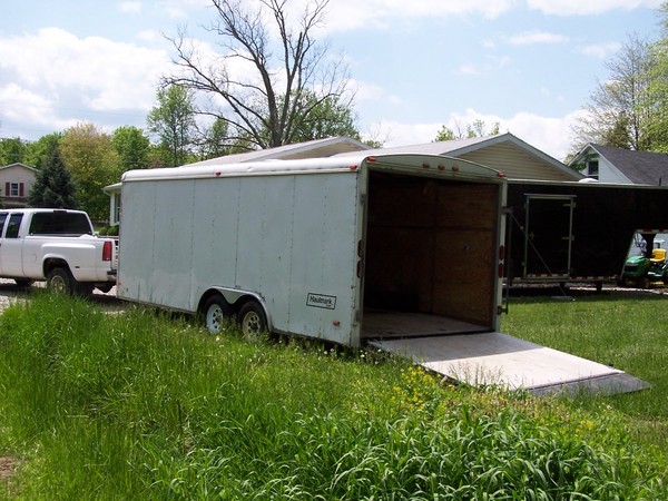

Well, Now I'm not sure. I am buying a new trailer for the race car. It will be dedicated to teh race car. This way I can leave all the tools, spare parts and such in the trailer. I planned to just buy a 20' open trailer and put a box and tire rack on teh front of it. But then I came across this enclosed 20x8.5 for $2300. The pics the guy posted, it is a little banged up, it has quite a few dents and dings. Especially for a 5yr old trailer. The tires and bearings were just replaced and it does have good trailer specific tires on it. I don't NEED an enclosed, I can get another 20' open trailer for $1800.
I had budgeted to buy another open at $1800. The enclosed is really nice except the dings which are cosmetic. But is it worth the extra $500. I tried getting the guy to come down but he wouldn't budge. $2300 is a fair price I think so I can't blame him.
Here's the pics he sent me. Some dents across the top and a big dent on the right front.

That corner peice that is dent is a replaceable part from HAULMARK not very expensive. I hit a chunk of a semi tire and did the same thing to mine and repaired it. I have towed a 24 ft enclsed with my expedition it handles it well if you get a good hitch with load leveling bars this helps tremendously. No it is not a ball of fire but it does the job at 60 mph. If I want to go fast I use my crew cab diesel with chip and big exhaust I run 72 to 75 with it and get 13 mpg. Just a little info for you

Thanks guys! One thing I just noticed is the front top. it looks like it has a plastic cover in that area and it looks like it is cracked?
Now to try and convince the wife to spend $500 over budget.... :P
