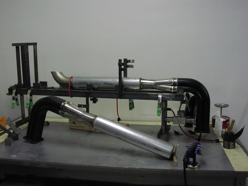

Cone Engineering merge collector progress pic.
Ingenious tool to align and hold the merge cone. The other merge cone is welded up. The collector itself is welded, sanded out, and somewhat polished both inside and out. I'm still throwing around different ideas on design from there back though.

I guess I could have cut it anywhere I wanted to. I made a fixture to align and weld on, so I just layed everything out and trimmed accordingly. I left the primaries as long as they were and trimmed the turn out since to me that is not the important length to worry about.
