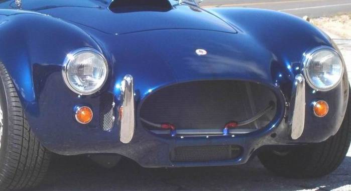

twobjshelbys 02-16-2009 06:34 PM
I think the look of the fans on the front is awesome, but we have too much stuff on the roads here to leave the radiator and oil cooler naked like they are. I had it up on the lift today and I think I can make something out of a tight mesh that could be connected easily that would look similar to the existing aluminum. Working...

Frank Messina 02-25-2009 02:58 PM
I made this one with a frame kit and some aluminum screen I got at Home Depot. Works great, no cooling issues at all.
http://www.clubcobra.com/photopost/d...Rad_Screen.JPG
Frank

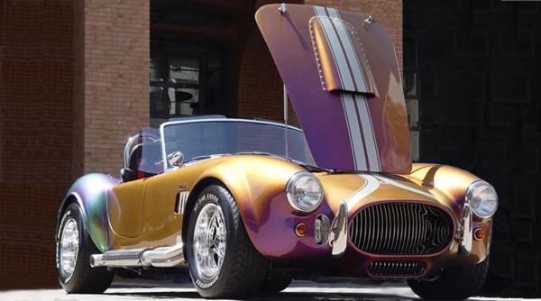

"Q" 03-02-2009 09:04 PM
Grille Set
http://www.clubcobra.com/forums/pict...pictureid=1316
This Grille Set was made by first making an oval shape out of stainless bar that follows the contour of the "mouth". Stainless bars are then bent "bow" shape and welded onto the oval. This is then mounted as close as possible to the radiator. The gap between the radiator and the Cobra's "mouth" is then finished by inserting a highly polished stainless trimming all round. On the car in the picture this exercise was repeated in the bottom opening as well as in the bonnet scoop. O.K it is not as easily done as explained, but you get an idea. Maybe not for the purist, but the result is stunning. There are more examples on my gallery and Album.
Bill Bess 03-03-2009 04:46 AM
Very Nice Job! Looks custom, professionally done, and adds some class to the little bugger.
Bill
"Q" 03-03-2009 08:44 PM
Thanks Bill. Another example added (taken with the flash on, hence making the radiator visible). The Grille theme was even incorporated into the Brake air ducts.
http://www.clubcobra.com/photopost/d..._and_Natie.jpg[/IMG]

"Q" 03-04-2009 09:13 PM
Cutom made inserts for air intake
Hi Glyn
Unfortunately not available over the shelf. It is basically the same process as with the grille set. Take a thin gauge strip of highly polished stainless steel (either cut or buy in the width that you desire it to protrude inwards). Measure the diameter of the side air intake and ad a little bit extra (enough to spot weld the two ends together). Now using various round shapes (pipes, bottles, the wife's rolling pin, anything that basically gives the same curve as the top and bottom curves of the side air intakes), bend the plate to follow the shape of the air intake. When you have the shape of the air intake and the funnel can tightly slide into the intake hole, spot weld together. That was the easy part. Now to get the small lip that follows the edge of the side air intake, you need a small hammer, a surface with a small rounded edge and a lot of patience. Taking the "funnel", you place the edge on the rounded surface and start "clinking" the edge over to create the lip. Keep test fitting as you go. Once the lip is finished all round it will more than likely have some unevenness, this you sand down. The final touch is then to buff the lip up to a brilliant shine. Slide in place and mount (silicone works nicely). Not for the faint hearted. Good luck if you wanna give it a bash.
