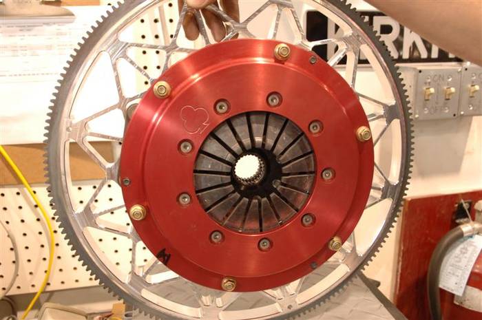

This set up is for a Tremec TKO 600

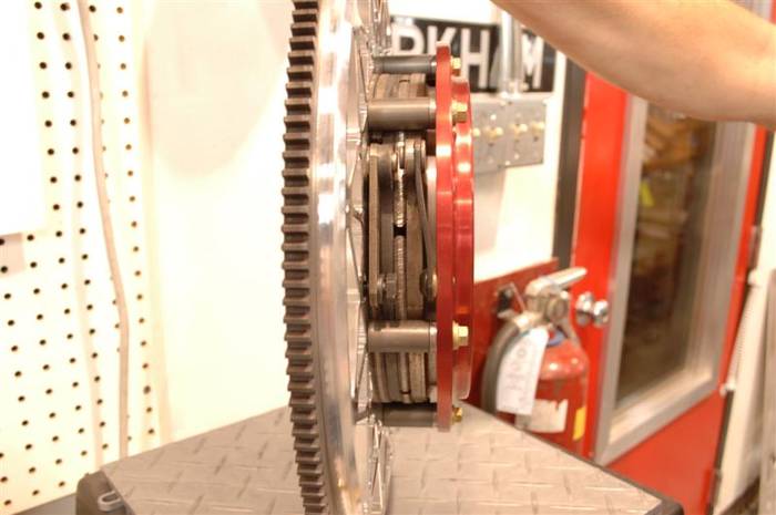

Here you can see the twin clutch disks.

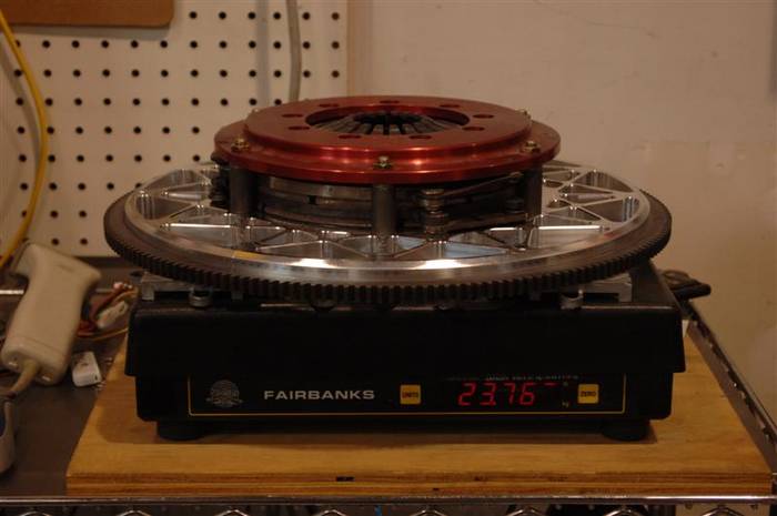

Now for the good stuff..
This entire set up 23.76 pounds!

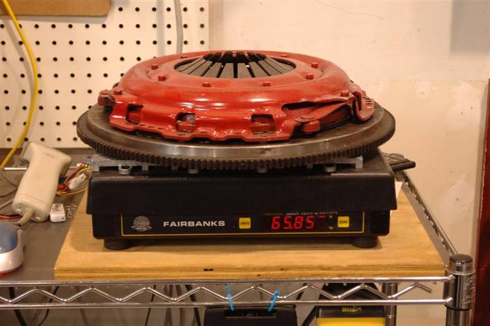

This is the original type set up with a steel flywheel and normal pressure plate. It weighs 65.85 pounds for a 42.09 pound savings! Our new set up is about 1/3 the weight. No wonder the original cars reved up so slowly.

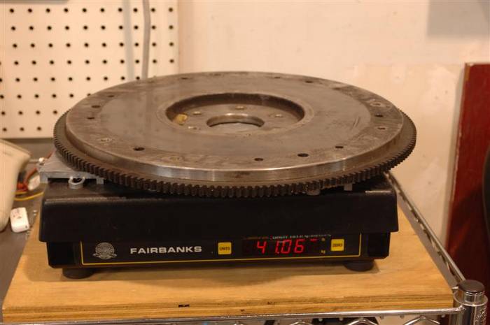

41.06 pounds for the steel flywheel. This is what makes putting them on so dangerous. I am always wondering if I am going to drop it on my foot.

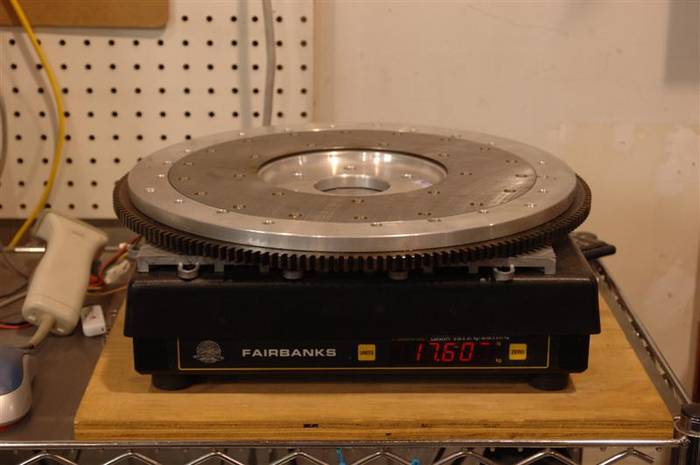

David Kirkham 06-06-2009 01:30 PM
At 17.60 pounds, a normal aluminum flywheel is less than 1/2 the weight of the steel moster. Now you know why the aluminum ones are so popular. We recommend everyone runs an aluminum flywheel--especially if it is one of ours :D

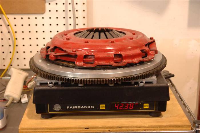

42.38 pounds for the aluminum flywheel and pressure plate assembly...still quite heavy--but a vast improvement over the 65.85 pound clutch from the M1 Tank.
Our new flywheel and pressure plate set up, however, is almost 1/2 the weight of the standard "lightened" aluminum set up. Time for testing...I have a tough job, but someone has to do it.

Did my eyes deceive me or did I see sintered iron discs in that uber light assembly? Two more questions; which McLeod pressure plate is that and how much plate load does it provide.
