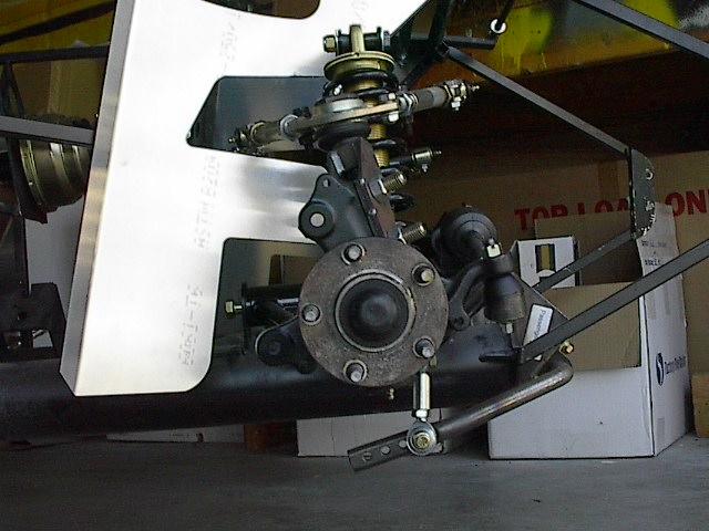

Here's a picture that may help you to explain how the "upper ball joint boss is in front of the lower". Feel free to edit the photo with notes, lines and such to help explain.
http://www.clubcobra.com/photopost/d...ball_joint.jpg
Bart Carter 05-14-2003 11:35 AM
OK, I'm looking at the picture. Looks like the upper ball joint is BEHIND the lower, not in front as intially stated.
How can the upper ball joint be in front of the lower and still provide positive caster. By definition, it can't. So the upper ball joint HAS TO BE BEHIND THE LOWER. Unless you put the upper A arms on the wrong side of the car!

Hmmmm,,,,,sure looks like the top ball is behind the lower ball....

I have never experienced the "bump steer" issues others claim to have. I don't even run the quad shocks. I spent the better part of last year getting my suspension to my liking. That doesn't mean it was no good, it just needed some "tweaking" for me. I don't know where someone thinks the upper joint is in front of the lower and the posted picture proves this point. We should remember we are dealing with a short wheel based car with a narrow track as well. That in itself will give you a ride if you're not careful.

I think Mr Bruce is talking more about the FFR adapter bracket itself, right? Solely based on that, he's right: pass a rod through the upper ball joint hole, and it passes forward of the lower ball joint hole. The spinde also angles the bracket forward, as viewed from above (see GatorAC's picture).
However, that's moot once the car is properly aligned: a line drawn through the upper and lower ball joints to the ground falls forward of a line drawn vertically to the ground through the spindle - that's positive caster. The relative angles of the ball joint studs are irrelevent (up to the limit of their travel) because they can pivot in any direction.
IMO, the reason for the angle on the upper ball joint is the original Mustang geometry: strut. The upper pivot in that case is the top of the strut tower. Let's assume that both an FFR and a Mustang use 3 degrees positive caster. Viewed from the side, the FFR upper pivot (ball joint) at ~10" above the lower ball joint is indeed farther forward than the Mustang upper pivot (strut tower) at ~24" above the lower ball joint - but the caster angle is identical, and in both cases the line to the ground falls forward of the axle centerline to the ground. So, Ford had to move the spindle-to-strut attachment point as far forward as possible to keep that angle to the top of the strut.
