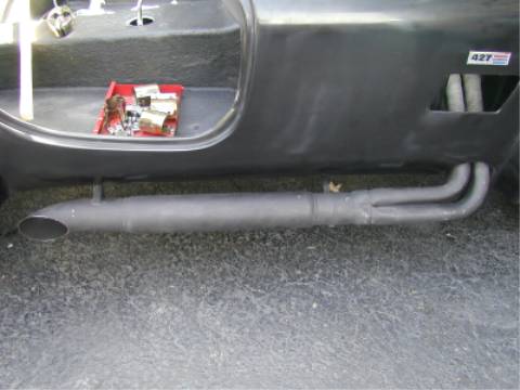

Roscoe 05-29-2008 05:13 AM
Ditto on the little sawzall. A must have tool. I cut mine similar to the way Jim did it.
http://www.priveye.com/cobra/SIDEPIPE.JPG
Roscoe
