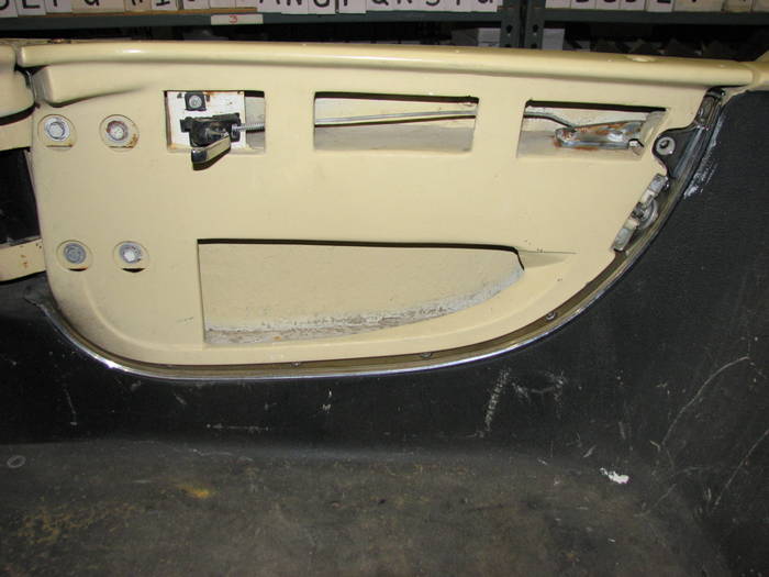

Just to clarify, the 2x4 I was referring to is in the door. The main frame rails under the car should be 3"x4". Both are .120 wall thickness.
The door hinges are 1/2" thick flat steel bolted to a steel plate that's welded to the 2x4 steel door beam running the width of the door and ending at the door latch (from a VW). This is the final version of the doors in all type 3 and 4 cars. There is no wood left and the tubular hinges are gone.
http://www.clubcobra.com/photopost/d...m/IMG_0184.jpg
Jason
Yetiman 04-20-2007 06:11 AM
The car in that picture is an interesting color...
KZJim 04-20-2007 07:33 AM
n6,
The hinges on the car I'm working on are similar and look to attach in the same place, but the inner door panel is diffrent and there is no VW door latch.
So it seems that what i'm woking on is a 1 or a 2 possibly.
n6opv 04-20-2007 09:54 AM
It's just epoxy primer... although it is quite a close match. How'd you get such a high gloss? :)
There's a bit more work to do before the car is painted...
Jason
