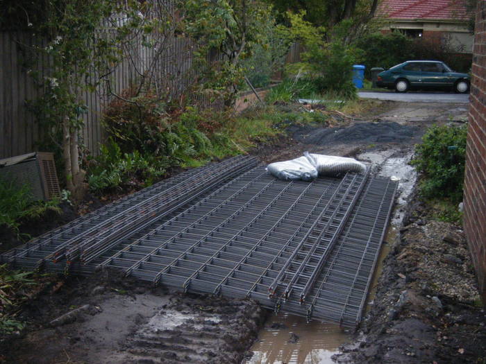

At 6.30am today the steel arrived...there is a bit of rain around today so they might be held up.
HAPPY STIFFY

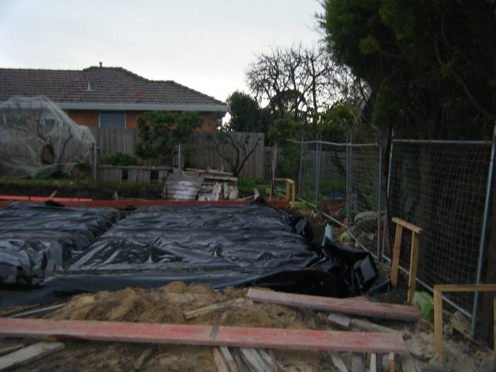

stiffy 10-12-2009 04:24 PM
Progress Finally
Guy's
The men have returned to box up and reinforce the slab.
By late today it will be ready for the slab:3DSMILE::3DSMILE::3DSMILE:
So if the rain holds off it will be done tomorrow, BLOODY FANTASTIC:rolleyes:

The 2 poster is in the middle of one of the footings therefore it will be in
500mm of concrete...... SAFE.....
STIFFY
PCC 10-12-2009 10:44 PM
6" is fine - 2 layers of mesh?
stiffy 10-13-2009 12:10 AM
I prefer 8"
PCC,
One layer of F92 plus the stuff in the footings.

Zedn 10-13-2009 02:18 AM
2 layers for slab on ground? Where would the tensile force on the top fibres come from? Usually that is used for suspended slabs and on ground designs with dodgy founding soil or funky loading. Residential garage slabs are usually only one layer. You must be used to the bigger stuff!
With F92 mesh and 150mm thick that is easily stong enough for your little daytona.. Unless you and Doug are planning on building a semi also?

Its not unusual to include a 2nd layer of mesh in a 150mm or thicker slab especially if there's no added fibres in the concrete mix.

plastic shrinkage cracking should be minimal in a 25mpa slab, especially in Melbourne. You are correct that it is not unusual to include a top layer of steel, but that is typical in suspended applications. Top steel is generally designed as per AS3600 where required in tensile zones that exist due to max moments in the top fibres near walls, columns, piles etc. It is also used sometimes to assist with tying stirrups for shear reinforcement and as you say control cracking due to early age, plastic cracks etc.
