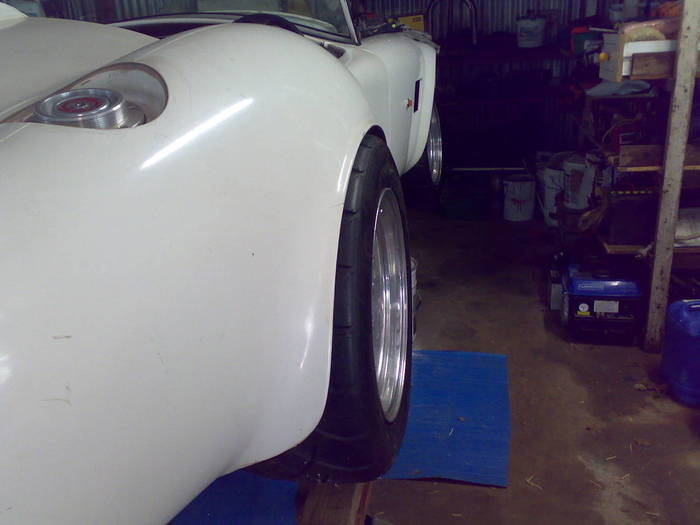

spookypt 10-29-2009 05:42 PM
http://www.clubcobra.com/photopost/d...3042009153.jpg
Make a mark on this wheel where the lip finishes on the guard and we'll see how it compares on mine!
