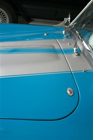

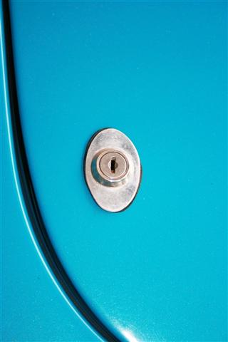

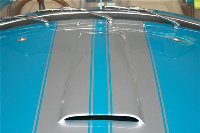

Baz 04-05-2010 07:16 PM
Hi Mando,
I purchased these flat key operated bonnet locks from our local Bunnings store in the Hardware section for $20 each.
http://www.clubcobra.com/photopost/d...s_2_Small_.jpg
http://www.clubcobra.com/photopost/d...cks_Small_.jpg
http://www.clubcobra.com/photopost/d...s_3_Small_.jpg
Regards Baz
sambo 04-05-2010 07:36 PM
Very neat Baz. Is it easy enough to get a finger under the bonnet edge to open it up? Having watched your build I wouldn't be surprised if you'd fitted a spring loaded stopper or something tricky like that.
