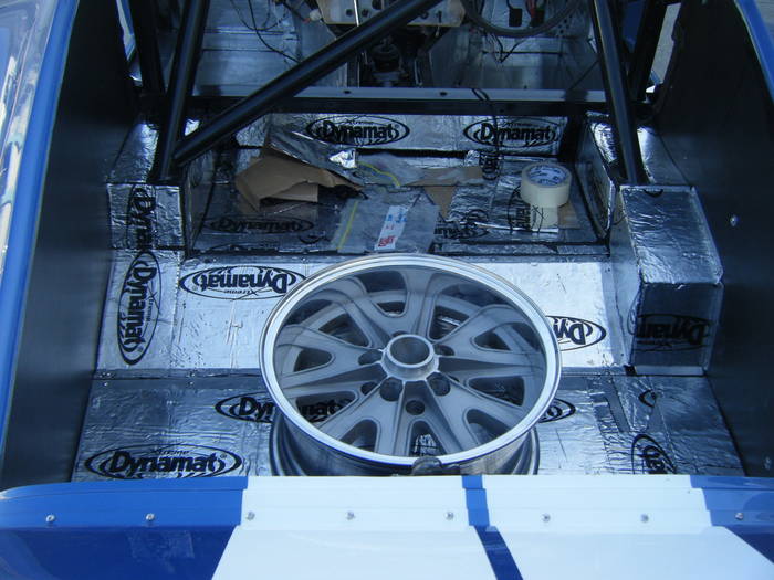

I have used Dynamat and a product called HEI Insulation. I picked it up from Summit with the Dynamat. I used 5 sheets of 1m x 1m stick on heat shield ( just enough ) and two large boxes of Dynamat. I went over board with both as the car was BLOODY HOT to drive. I also insulated under the tunnel with another HEI HI TEMP product ( 1700 DEG HEAT WITH 450 DEG SELF ADHESIVE GLUE ) very expensive ( $280 just to do the tunnel :MECOOL: ) the Dynamat and HEI product delivered was around $600 from memory. I also had the best heat resistant underlay installed AND carpet. I HPC coated the entire exhaust system.
Did it work????? As I type the car is gettting the A/C gassed and working correctly for my trip to Tassie next Month:eek::eek:.....
It certainly did help, dont know by how much but I can say I didn't leave any thing to chance. Its just a hot car to drive, probably similar to a GT40.

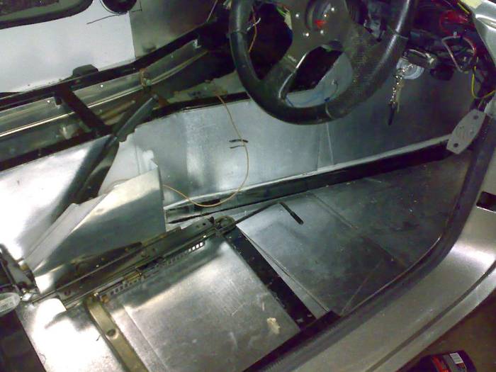

I used a product called Resomat available from Tru-fit Auto Carpets in Dandenong.
It comes in 3mm or 5mm thickness, 500 x 500mm self adhesive squares @ $12.00 each. Quite heavy, bituminous, aluminium sided for heat and sound deadening.
Really easy to apply, sticks fine after you use a good thinner type cleaner first.
Can't vouch for it yet as car's yet to run.
I have also HP coated extractors.
Greg
