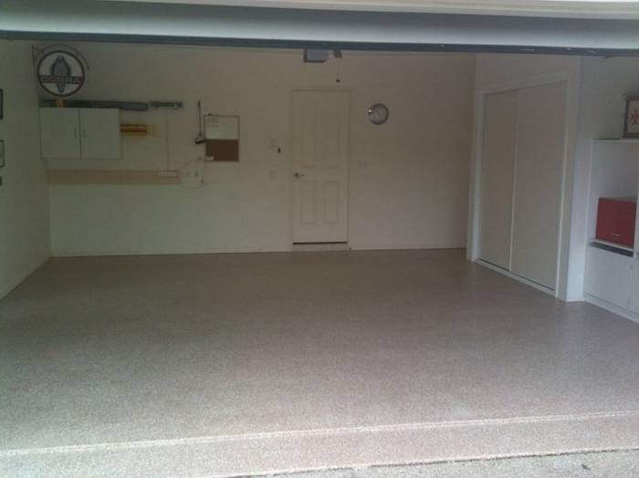

Merv and Sharon 02-09-2011 12:30 AM
All done Dave. An impressive product. Has a 2 pack epoxy base, flake and then 2 pack urethane top coats. Very tough stuff and resistant to almost every fluid known to man. Can be driven on in 24 hrs but I will wait 48.
http://www.clubcobra.com/photopost/d.../Garage_11.jpg
http://www.clubcobra.com/photopost/d.../Garage_21.jpg
The cost was about $800 more than I could buy the materials for and included a diamond cut re-surfacing of the concrete, acid wash, etc. Was (only) 38 sqmtrs.
leroy17 02-09-2011 01:49 AM
Looks good Merv, and will be easy to keep clean as well.
I have garage floor envy.
Cheers.
