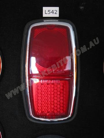

Tail Lights
Hi all.
So while I am waiting for the kit to arrive, I can begin musing some of the details. One area I am considering is the tail lights. As albanycobra pointed out, the kit tail lights will not be good as it has no amber lenses, so as a minimum I will need to fix that. But I do prefer the look of the original flat style tail lights. These ones I mean: http://www.clubcobra.com/photopost/d...ail_lights.jpg Sadly however they do not seem to be ADR approved. So in a search for substitutes, I did find these. http://www.clubcobra.com/photopost/d...ail_lights.jpg Has anyone done anything like this, and does it look ok? They seem to be a touch bigger than the originals, but the shape is right, and they are ADR approved. No chrome trim edge though. Comments? |
