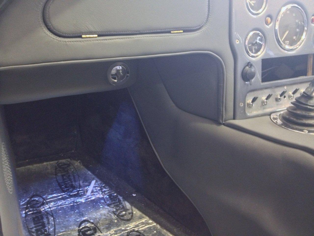

Wazza 12-29-2012 12:34 AM
Hi Guy,
Thanks a lot....
There's a vent/outlet on each side....
http://www.clubcobra.com/photopost/d...0/IMG_3611.jpg
http://www.clubcobra.com/photopost/d...0/IMG_3610.jpg
and we've tested them, and the air flow is excellent.
Rather than blowing directly out of each foot well, and straight on to the driver or passenger......the mushroom shape of the centre of the vent when it's "popped out", sort of spreads the warm air from the heater outwards, and back towards the feet.
Also....When the heater is not wanted/used in the summer months...and you want some fresh air in the foot wells..( They can get quite hot in the summer)....
There's also a solenoid fitted to the heater, which stops the flow of hot water, and continues to blow fresh "coolish" air that we've ducted from the front of the car..
i.e. There's a glassed in channel that collects the air from the front passenger side brake duct, and up and across the top of the inner wall of the front wheel arch, to the heater...
( You can't see it, it's all covered with the black "Rhino liner" like the rest of the under guards, and it's hidden by the wheel.)
The plumbing for these vents and the demisters behind the dash , looked a bit like a bathroom wall when it was all going in....
http://www.clubcobra.com/photopost/d...923_-_Copy.jpg
but is all nice and solid, and works very well.
Warren.

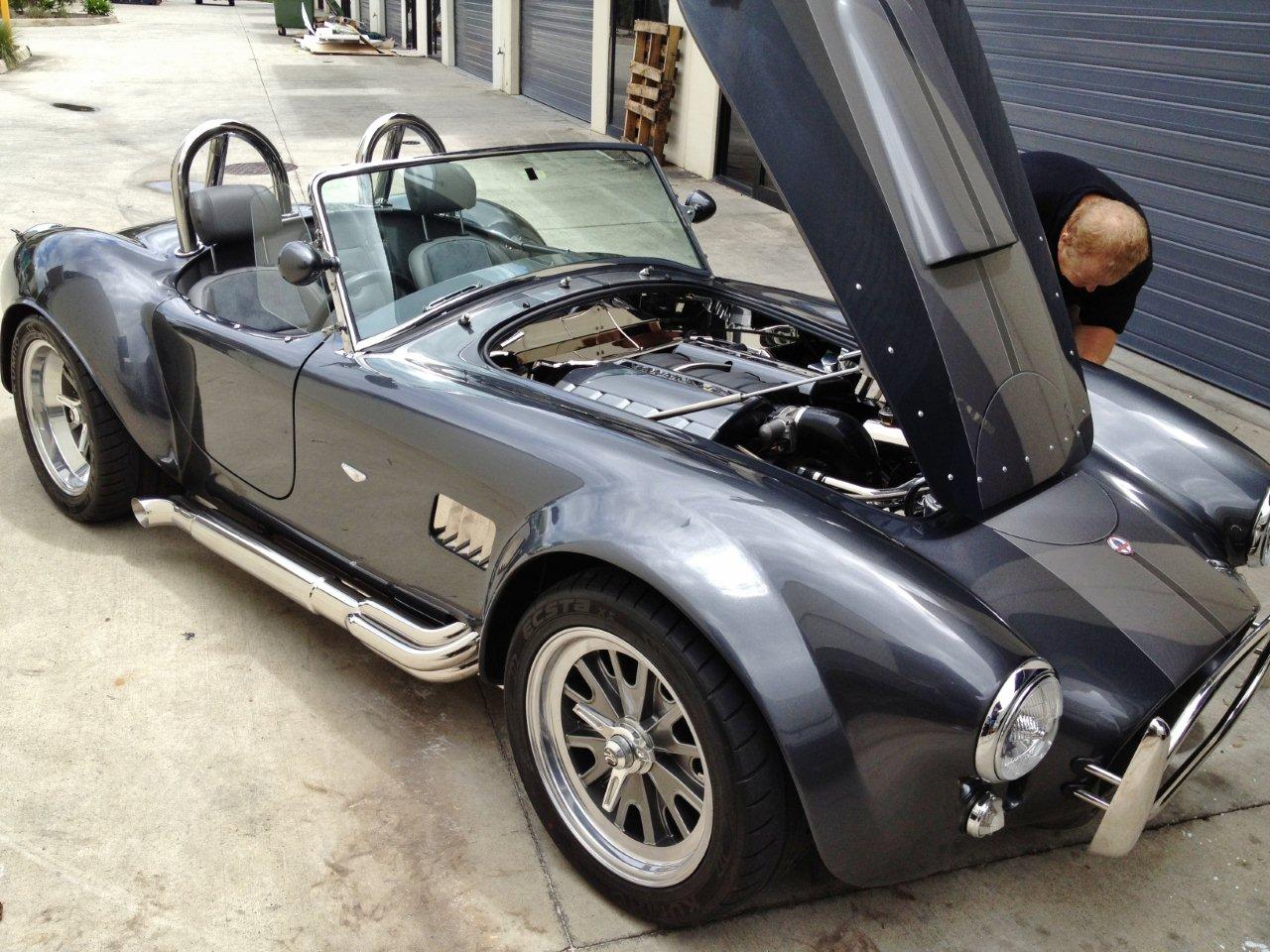

Wazza 02-13-2013 05:33 PM
FINISHED !!!!!!
I THINK I can report that she's all done !!!!!
Waiting now for the rego process....so keeping the fingers crossed.
Took her for a bit of a run on Saturday...and apart from a final wheel alignment and some spring changes...Now done...I THINK it's finished.
I'll post some better pics when it's "over the line".
http://www.clubcobra.com/photopost/d...0/IMG_3889.jpg
http://www.clubcobra.com/photopost/d...0/IMG_3843.jpg
http://www.clubcobra.com/photopost/d...0/IMG_3893.jpg
Warren.
Modena 02-13-2013 05:51 PM
looks great! What seats are you using, and also what wheels are they?
sambo 02-13-2013 07:38 PM
Love the mirror stainless on top of the foot boxes and the firewall. Might be pinching that idea!
stiffy 02-13-2013 09:21 PM
Beautiful
Wazza,
Bloody beautiful, ready just in time for Shelbfest....:D:D
STIFFY
Wazza 02-13-2013 09:37 PM
The seats are a custom made from the same mold that I made seats for on the racecar...changed the width slightly so I could fit runners under the seat.
In the end...I binned the bloody runners, because it all took up space we couldn't spare.
The wheels ?
They're HA17, from Vintage Wheels in U.S.A....
17 Inch X 8.5.inch front.....and 10.5 inch rear.
HA17 wheels PLUS adapter spinner kit ADTRSET : Welcome to Vintage Wheels, Online Store
Warren
