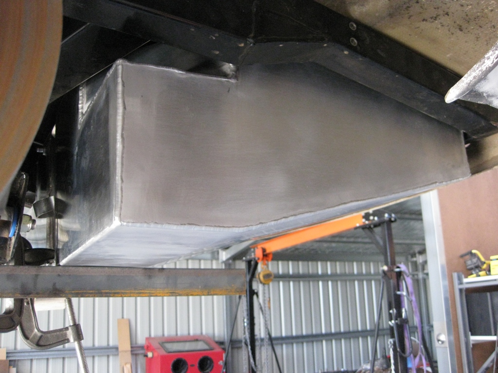

A bit of an update.
The tank is nearly finished. I'm now working out the mounting for it.
http://www.clubcobra.com/photopost/d..._left_side.jpg
I decided I didn't like the look of the smooth corners so re-welded them.

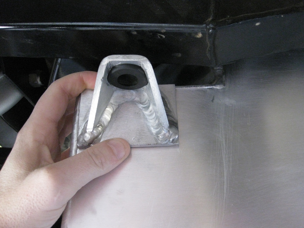

Here's what I'm planning for the mounts.
http://www.clubcobra.com/photopost/d...ank_mount1.jpg
I’ve folded up some brackets from 5mm plate and then welded them to a 5mm backing plate. These will be welded onto the sides of the tank (2 on each side). The idea of the backing plate is to spread the load over a larger area. Just welding the u shaped section straight to the side would concentrate too much load in one area and it might tear out at the weld.
The brackets will attach to bosses welded to the rear chassis clip and be isolated by the rubber grommets. They are rear bumper grommets that I’ve adapted to the task.

How are you going to stop the bolts for the tank vibrating loose?
I have done mine by putting a nolothane bush between the tank bracket and the chassis and then tacking a tab onto the bracket so it can be bent down to lock the bolt and stop it vibrating loose.
Aussie Mike 08-22-2011 04:04 AM
There will be an aluminum bush that runs through the center of the rubber grommet that will be bolted solid to the chassis. The bush will have a mushroom head on it that will sit against the edge of the grommet and hold the tank up in place. Apart from locktite I may drill the bolt head and safety wire it to the bracket.
I'll post some pics of the setup when I get it in place.
