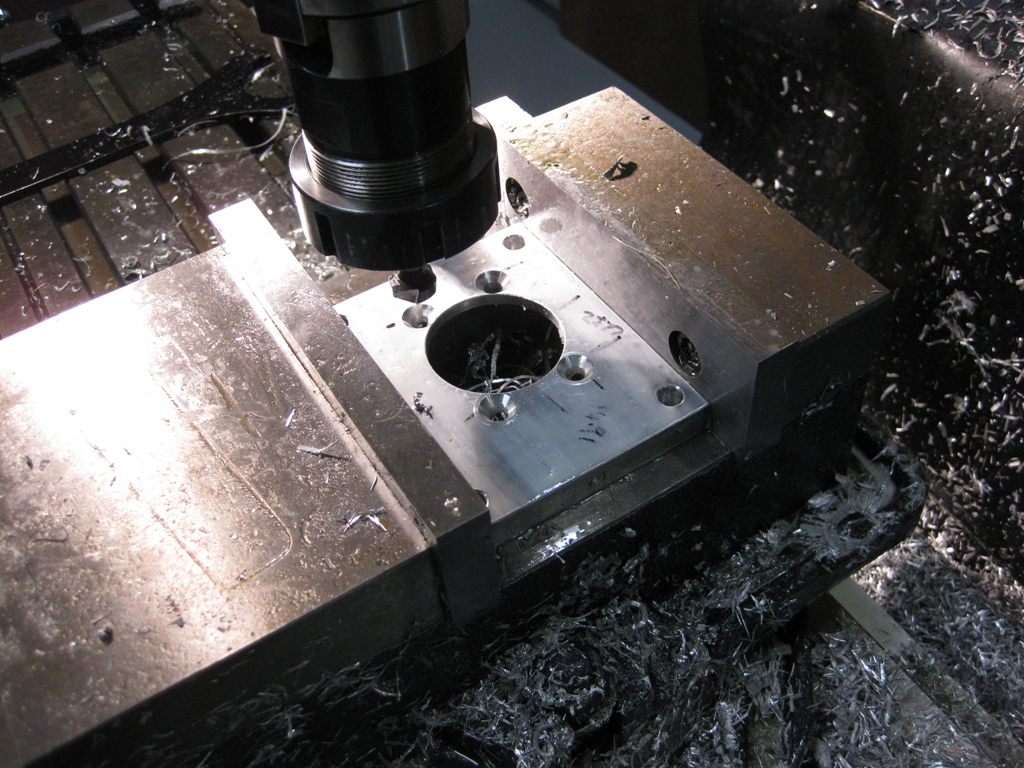

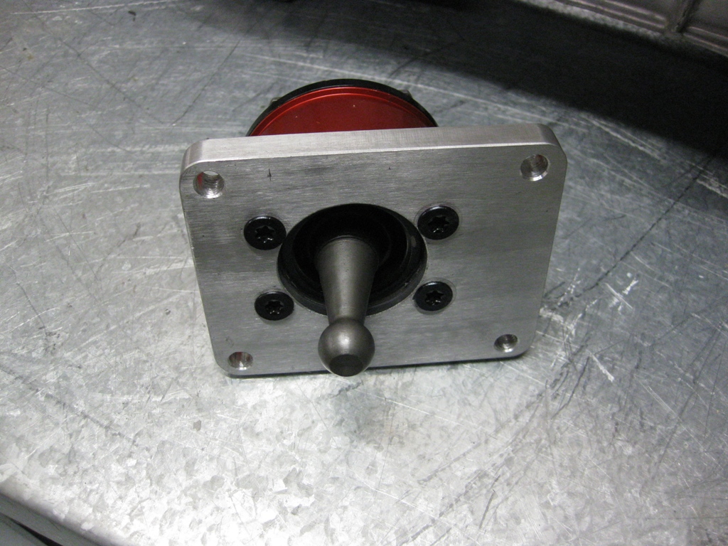

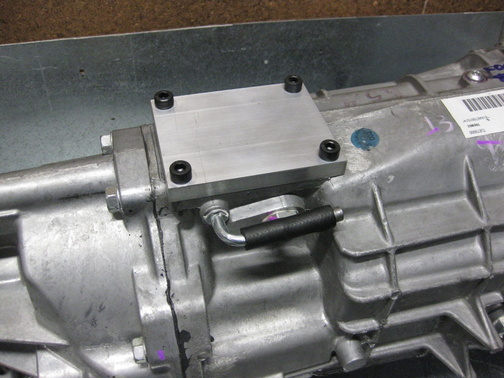

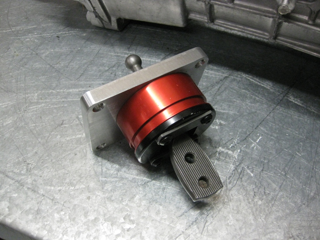

The last couple of boxes I've built I've machined up my own shifter bases rather than adapting something else.
Starts put with a new plate machined to the right dimensions and bolt holes.
http://www.clubcobra.com/photopost/d...se_plate_1.jpg
Machining for the shifter insert.
http://www.clubcobra.com/photopost/d...se_plate_2.jpg
Finished Shifter
http://www.clubcobra.com/photopost/d.../Shifter_1.jpg
http://www.clubcobra.com/photopost/d.../Shifter_2.jpg

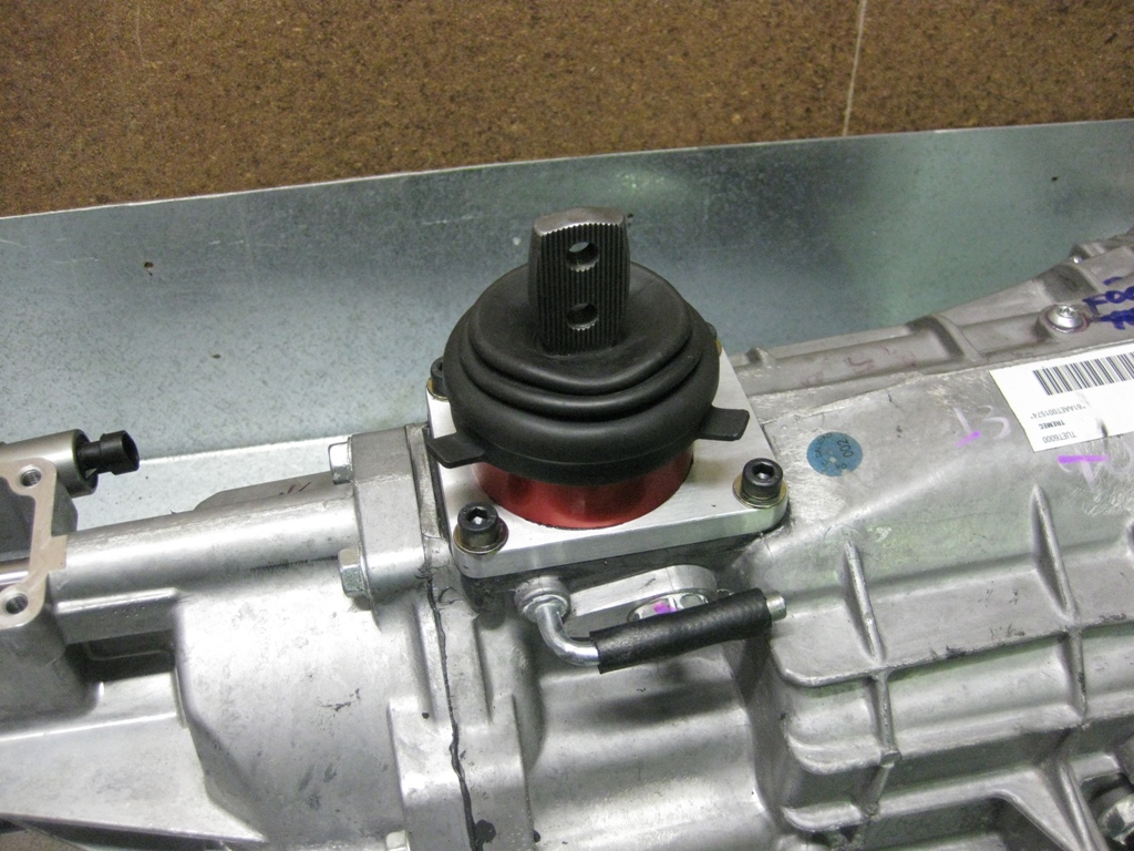

Installed and ready to go.
http://www.clubcobra.com/photopost/d..._installed.jpg

The shifter came from Keisler. I bought several T56 shift relocation kits from them hoping to save some time and machining when doing gearboxes for people. It had the opposite effect. Unfortunately the dimensions and geometry on their shifter was ****house. The bolt pattern was wrong and it wouldn't even bolt up and then the ratios in the shifter mechanism were awful and it wouldn't engage the socket in the shift rail correctly. Maybe I got a bad batch but I had to machine the new bases to make them work properly. The shifter part itself is a nice piece just the fitment was not good.
