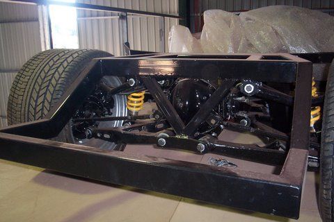

Im using an Au IRS narrowed 200mm......custom made top arms and Driveshafts...its been fitted with a nine inch centre since this shot.... 6.5 inch front space rims
http://www.clubcobra.com/photopost/d...k_end_0138.JPG
How did you fit a 9 inch center? Is there a kit you can buy?
I built my own chassis....Built with Jag centre...used an alloy 9 inch IRS centre direct jag replacement from Diff Technics at Kogarah...But they dont make them any more
