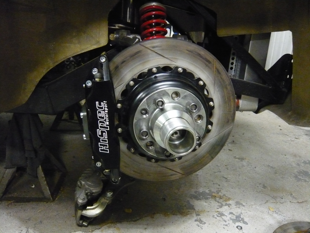

Aussie Mike 06-25-2012 07:22 AM
The aluminum hat section is a significant weight saving over a conventional rotor. Also if you machine your own hats it opens up a lot of possibilities for different offsets.
Also a lot of 2 piece rotors are also set up as floating. The rotor can move side to side a little independently of the hub. This means you don't feel so much brake shudder through the pedal as the rotors warp under extreme conditions. Its usually a race track only thing since the floating mounts are another wear point you really don't need on a road car plus they can be noisy.
Aussie Mike 06-25-2012 07:28 AM
The other advantage I should also mention is that when it comes time to replace your rotors you only need change the disc section. You can re use the hat. This can be a cost saving as opposed to buying complete rotors (depending on manufacturers).
These are 343mm x32mm 2 piece rotors. They are probably lighter than the 330mm x28mm 1 piece rotors I had on it before.
