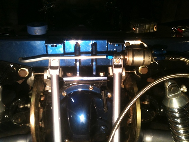

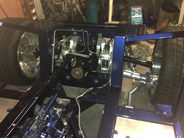

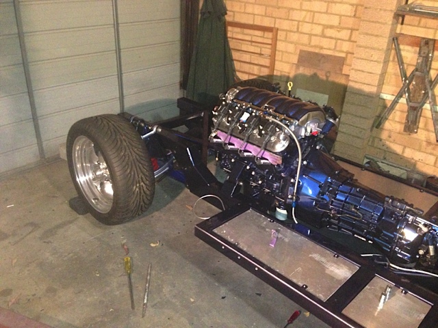

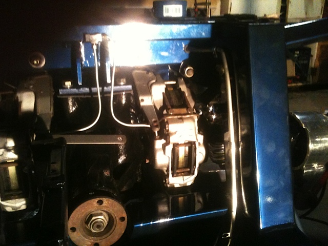

I have installed a walbro high pressure pump in tank and then used the corvette filter with built in regulator. Im pretty happy with it so far but im yet to start the car.
I have one fuel line and then another line for the evap to the charcoal canister.
http://www.clubcobra.com/photopost/d.../IMG_01321.jpghttp://www.clubcobra.com/photopost/d.../IMG_01521.jpghttp://www.clubcobra.com/photopost/d.../IMG_01612.jpghttp://www.clubcobra.com/photopost/d...0/IMG_0180.jpghttp://www.clubcobra.com/photopost/d.../IMG_02331.jpghttp://www.clubcobra.com/photopost/d...0/IMG_0133.jpg
750hp 01-20-2013 02:37 AM
Beautifully fabricated, as always Mike. I haven't seen how far people push the envelope with dead headed systems. Are you confident that there won't be a pressure drop in the fuel rails at WOT?

Aussie Mike 01-20-2013 06:20 AM
Thanks Craig.
My theory is that the rails are 3/4" ID which is quite a bit larger than stock. The main line feeding them is 1/2" where the stock line is 5/16" I think. So there is a heap more flow and volume in both of those which should keep a good head of fuel available. Then the Pump is an 044 which will be able to keep up with any demands I can throw at it.
Hopefully the regulator will respond fast enough to keep up with any pressure drop.
Fingers crossed it all works.
